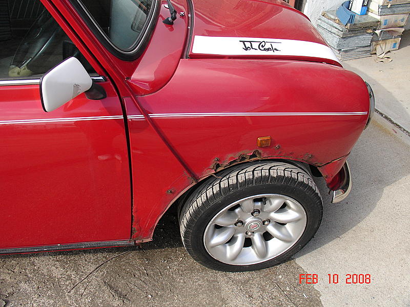

[FONT=Times New Roman][SIZE=3]I have a classic mini cooper and it was hit will it was parked. I finally got the whole front end and I like to know how to change it. I will like to do most of the work my self with my son although his is only 9 years old it’s never to young to learn…. [/SIZE][/FONT]
[FONT=Times New Roman][SIZE=3][/SIZE][/FONT]
Attached Thumbnails Changing the front end...-11-12-.jpg   Changing the front end...-11-22-.jpg   Changing the front end...-11-11-.jpg

that sucks big time. Check out Mini Mania- you could get the fender, hood, shocks, subframe- whatever you need, for a good price. its not too much work from what i hear. think about doing a flip front (all one peace). it takes more time but the result is a custom, smoothed out front. nice ride BTW.

LOOKS LIKE you'll need a fender and an A panel the most challengin will be the A panel to make sure the door closes properly.

It doesn't look like you just need to replace a couple of panels... you've got windscreen scuttle damage and likely damage to the a-pillar that the door hinges hang on. Also you likely have crumpled inner wings, at least the front portion that holds your front panel.
If you insist on DIY-- I second the advice that you go to a local junior college body repair class. Don't cut off any panels before taking it there as experienced body people want to see the damage and see the best course of action to undo what was done.

Wow what a bummer! Was that imported that way? I noticed what looks like a customs shipping sticker on the windscreen.
Most of that work you can do by yourself. That looks like the normal front end restoration. The only problem place I see is reskinning the door.

Nah... I don't agree with you on that. Swapping out a new front or rear subframe is a snap on a Mini. Now if the body shell itself was twisted during the accident, then it become more difficult when it comes to weld on the new panels.
From the images the front subframe look fine. Most of the damage appears to have happened from the passenger side headlamp outward to the fender panel. This leaves me to believe the impact missed the subframe totally. So any minor twisting to the subframe can be knocked back into place.
But having really inspected the damage on the photos. This accident may be a blessing in disguise. The whole front needed to be replaced anyway due to rust. Look at all the rust holes on the driver side wheel well and A panel and the bubbles under the headlamp.

[FONT=Times New Roman][SIZE=3]Finally got the front off and could not stop looking for rust so now I have the whole car dismantle…..sorry could not put up pictures because the site kept asking for URL image and I didn’t know how to do it… [/SIZE][/FONT]
Old Apr 9, 2008 | 05:51 PM
Minimad's Avatar
Minimad
Joined: Dec 2002
Posts: 1,539
Sheetmetal is cheap. All your shiny bits are good. The job isn't as hard as it looks. If you have some basic welding & sheet metal ability, you'll do fine. The A panel alignment isn't too bad to do. Remove the door. Grind off the rear edge of the A panel. knock the spot welds off at the scuttle panel, drill out fender spot welds, remove with front fender. A door skin isn't bad. Just grind the edge front, bottom & back until it separates. Fold (carefully) on a new one.
