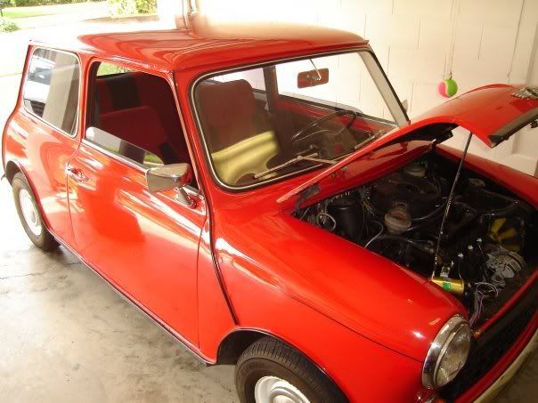

here is a car im restoring for a guy in Orlando FL, for those of you MiniCreation Fans who love to follow my builds.......

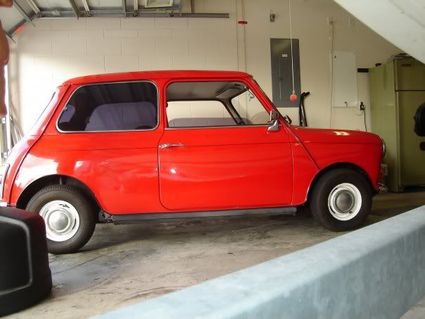

This Is How I Got It:

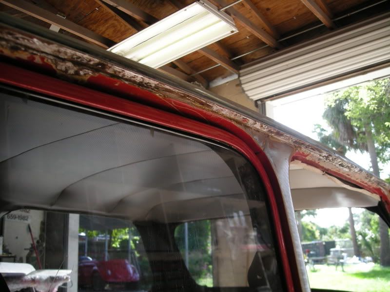

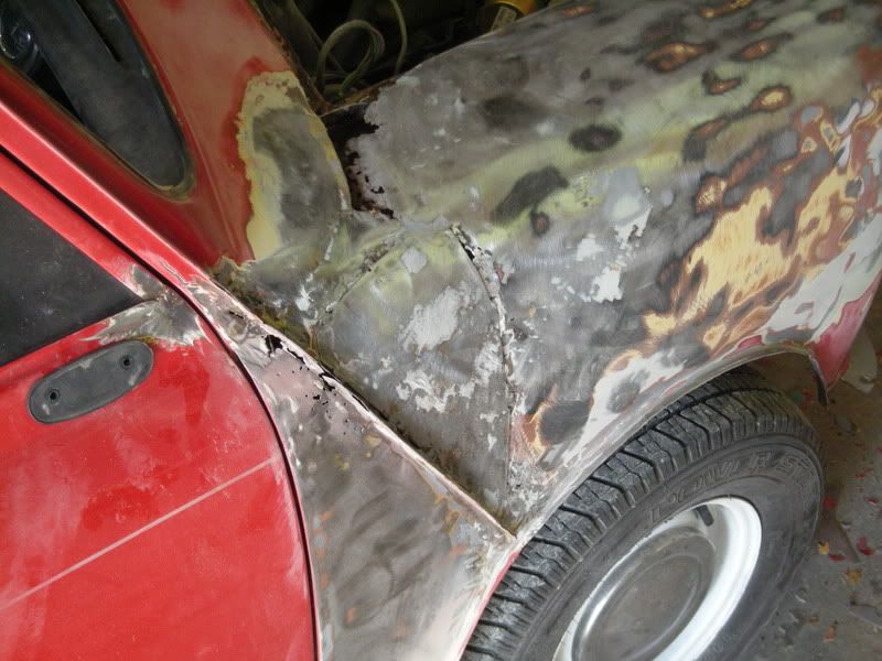

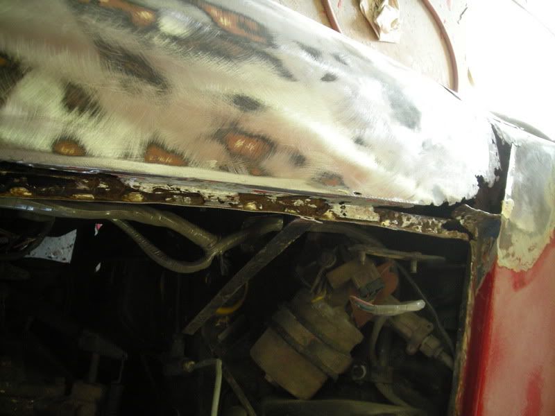

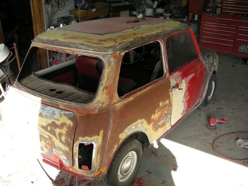

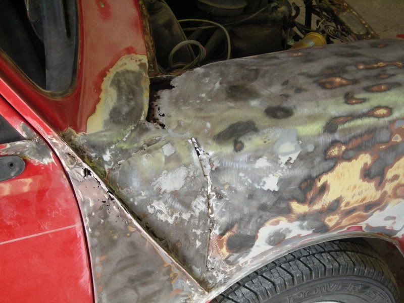

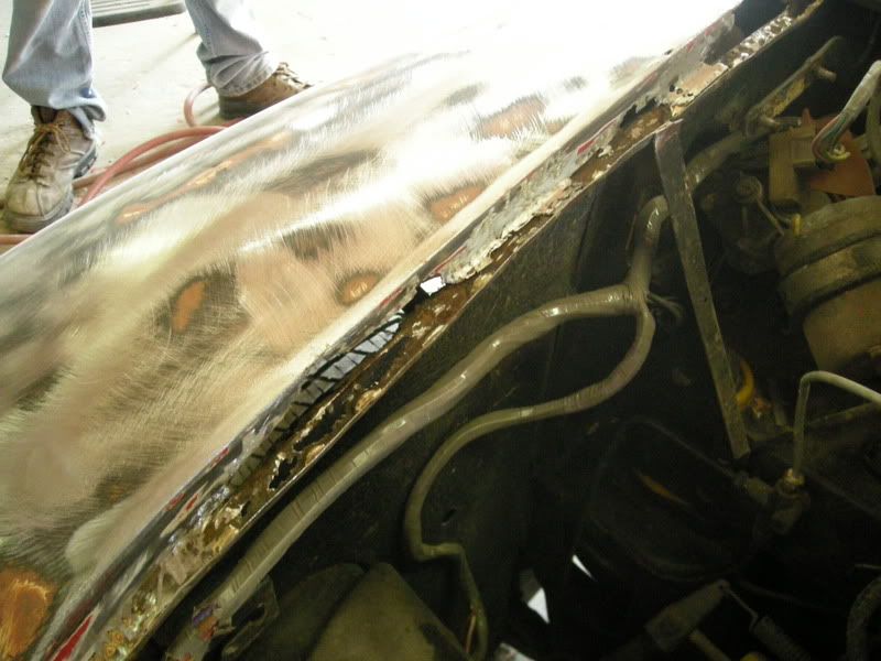

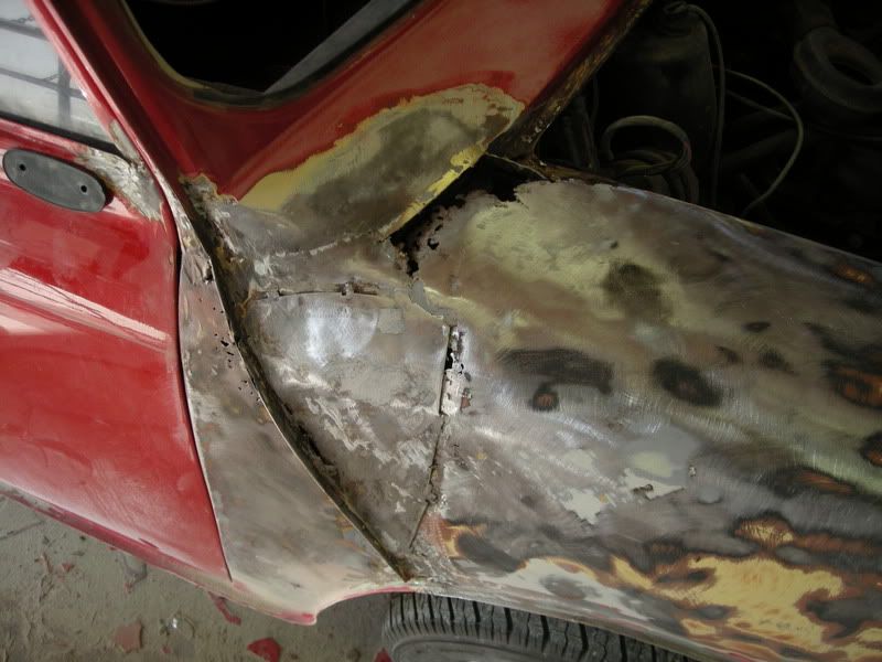

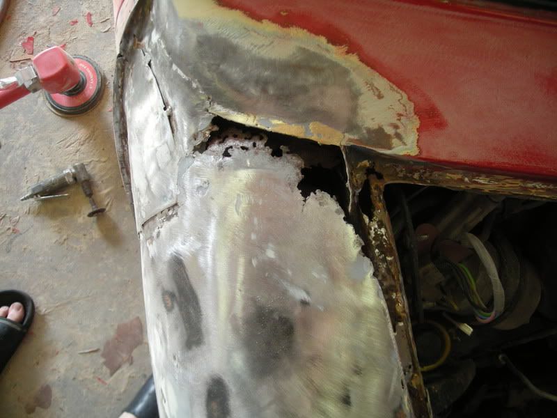

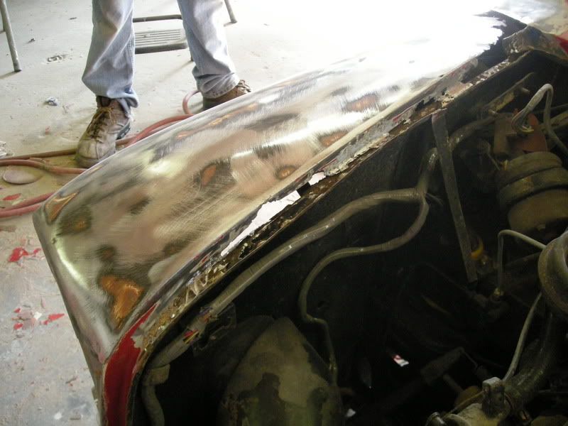

This Is After Hours of Stripping the Car:
Que The Music " B. O. N. D. O. and Bondo was it's Name-O" ..........it always amazes me to see how many layers upon layers upon layers when trying to get to the metal......lol......

I was just going to say the same... but you beat me to it, bigNorm. Wow, lots of room for rust to hide. Could you see the welded-in patch on the right wing before stripping? Hard to tell in web-quality photos.
Old Oct 8, 2007 | 04:58 PM
Big Norm's Avatar
Big Norm
Posts: 1,284
From: St. Petersburg, Florida
could not see it at all......i couldn't believe it.........there was tons of fiberglass and aluminum foil........lol.....no kidding.....this car looked to be in pretty decent shape when me and the cust. did a walk through after he brought it to me..........i would have never guessed..........as everyone knows, some of these mini's come with tons of bagage, you really see it's true colors after tearin into it.......

there was prob 1/4" of bondo on the bad spots..........just goes to show, that you never really know, untill you get to the metal

the bondo on this car was applied over fiberblass that was applied over rust....it was a lipstick job.......to avoid replacing panels all together, were gonna cut out the rust and patch in new metal.....of course we will have to skim it all with bondo to get a nice smooth surfave for paint, but the key is to do it all correctly.......

How did you know to strip the paint? Looking at the 1st pic, I would have assumed it was a clean car and continued merrily on with driving it.
Old Oct 10, 2007 | 10:17 AM
Big Norm's Avatar
Big Norm
Posts: 1,284
i alsways try to strip the car down.........beacause of these reasons.....at first glance the car looked great......i would have never guessed.......thats why it is always important to really go over everything on these before buying........tap your fingers on areas that are of concern....should sound like metal and sould not be hard as a rock.......

well, we got all the bad metal cut out of the fender and in the bonnet gutter, replaced with new metal and ran a skim of body filler over top and sprayed primer......came out great, I will post pics later of the final outcome.....there was a ton of bondo on the RH door that was filling in a huge dent......were gonna pull that out and hopefully it will be ok.......
