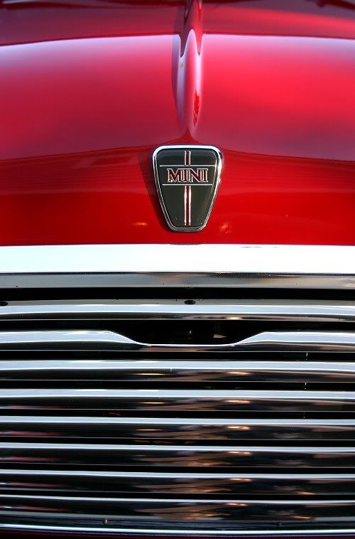

EDIT - here's the manual release in the front grille - it's the dark "slot" below the badge:

ok thanks i got it. i thought that was how but i was too afraid to push hard enough
