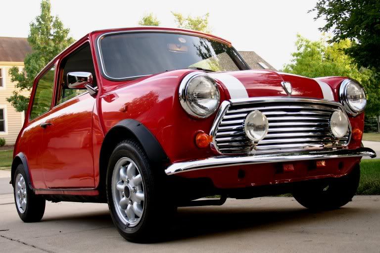

You need to think off road when you drive over those speed bumps. One wheel at a time over the obstacle.
There is a solution......
Attached Thumbnails Exhaust question - Cat hanging too low?-mini4x4tweek_web.jpg
