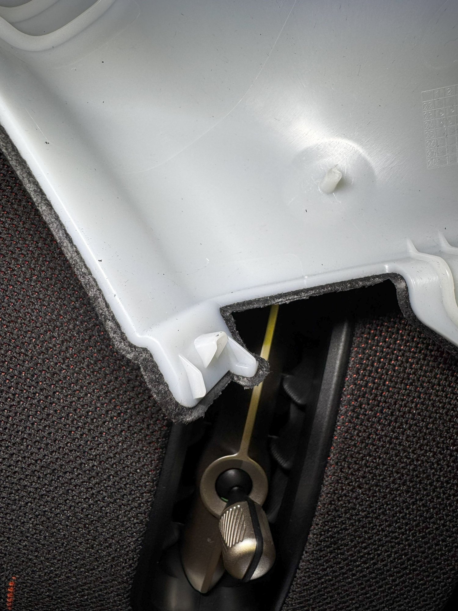

You can see the two hooks on the bottom of the trim
A Pill Trim
And here is what it looks after the A Piller Trim removed
Tip & Note: there is a small hook that was holding another small side trim piece. REMEMBER to unhook it BEFORE you pull up the A Piller.
Or you will be like me, damage/broke the hook on the trim piece underneath.

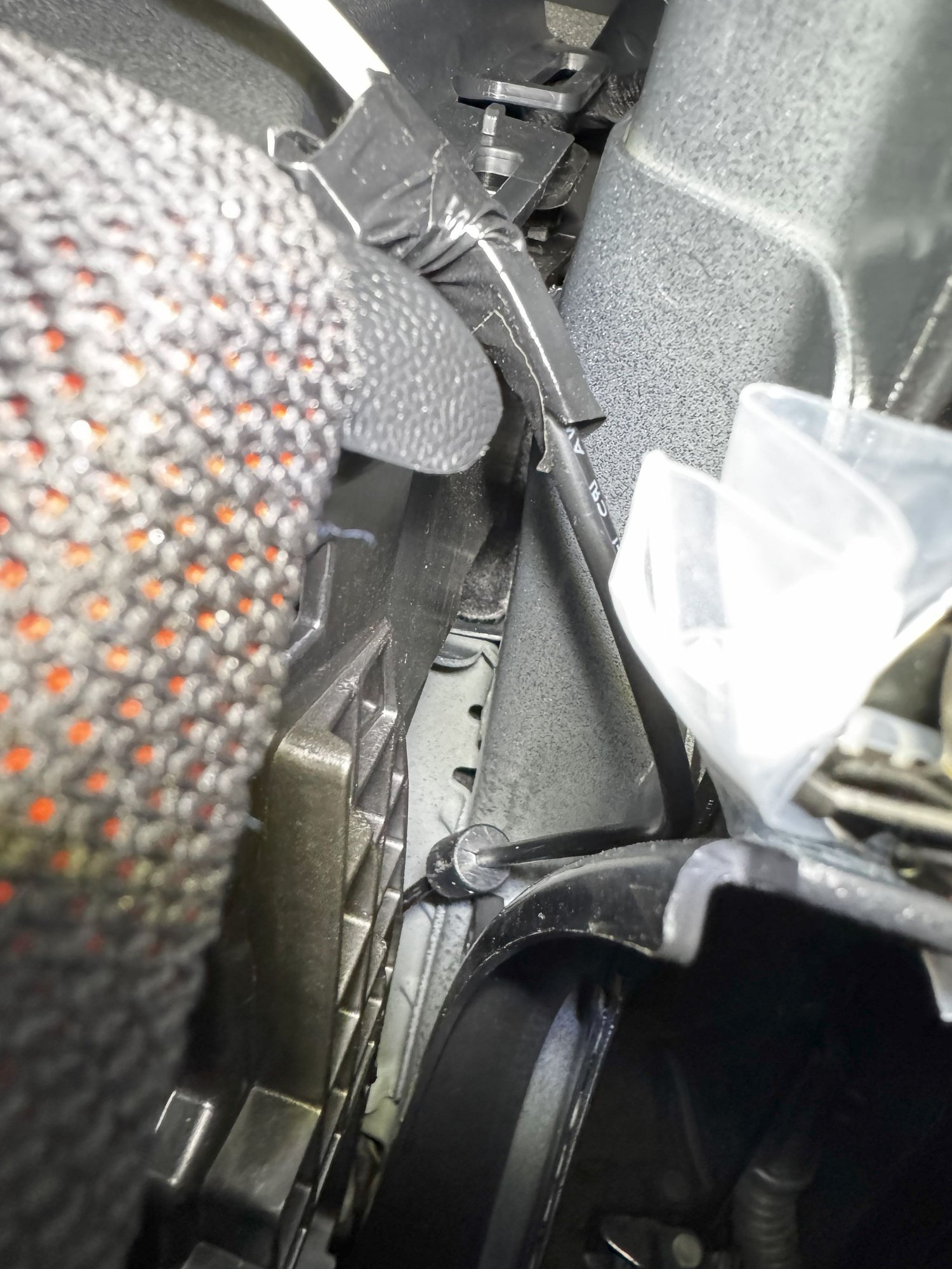

Route the power cable along side the A piller, tug it behind the cable harnes already in place.
Push the lump of in line ferrite bead behind the head headliner now then pull along is much easier instead of trying to push into it from the edge.

Zip tie the front power cable to the harness and tape down with Tesa tape.
Use some Tesa tape to tape down the cable near the B piller section to the headliner, make sure it's away from the air curtain.
Tape the camera cable to the zip tie where we ran through the harness grommet.
