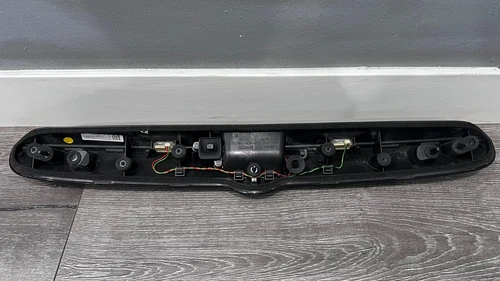

6 screws on the back side
15-19 MINI COOPER COUNTRYMAN F60 TRUNK LID GRIP Tailgate Handle JETBLACK - Picture 6 of 6
