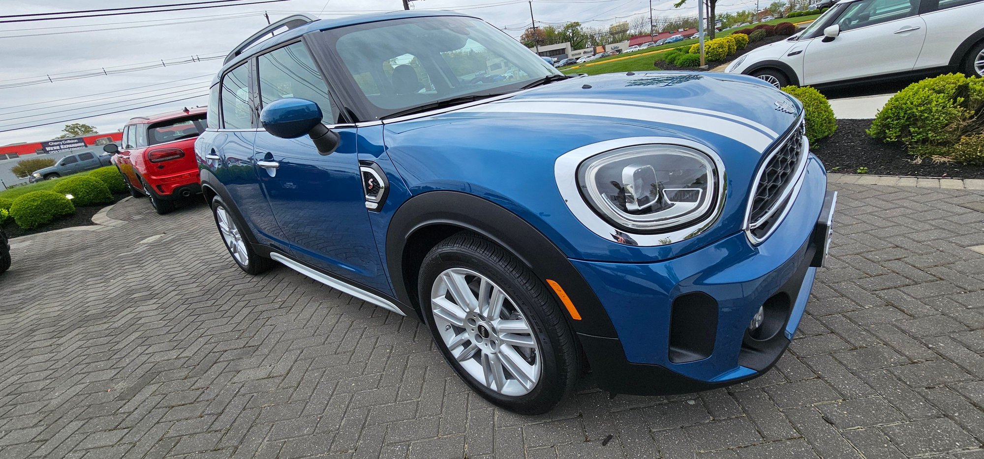

I'm a new owner. It's a 2021 Mini Countryman S All 4. You guys seem pretty knowledgeable and I'm hoping I can get some input about a potential issue with the car.
I recently got this car as a gift for my Wife for Mother's day. It only had 3000 miles on it, so it's a new car as far as I'm concerned. She's a new driver and still a bit unsure of herself when behind the wheel, but she absolutely loves it and has been driving it around everywhere.
