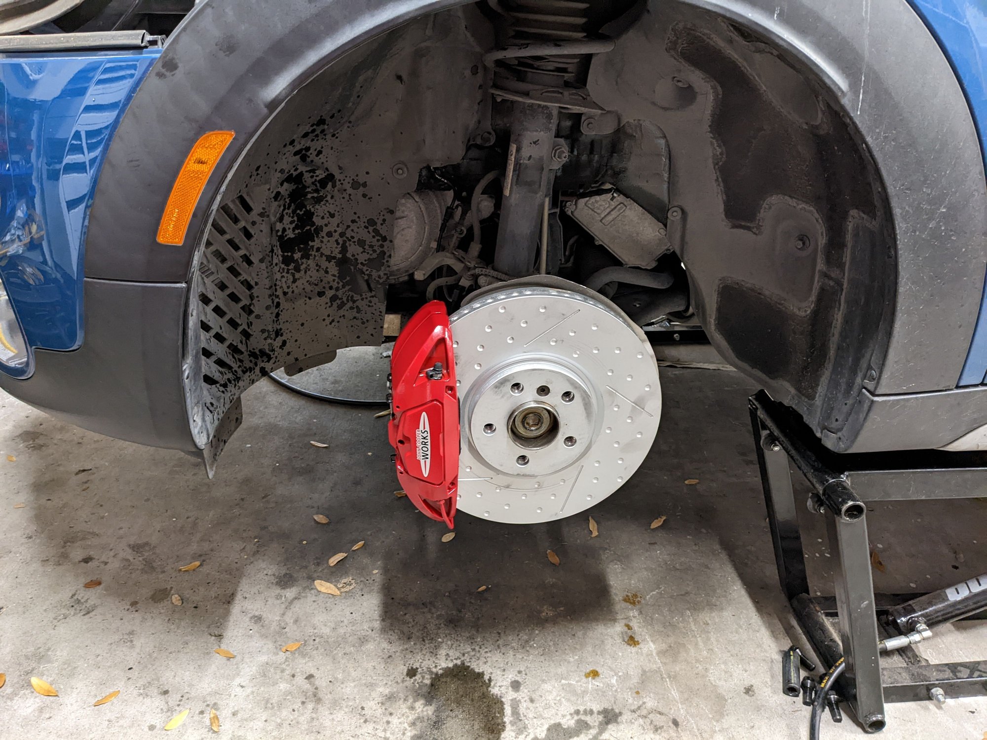

Here are a few more pictures
Originally Posted by zcspec
Jefferson, post up more pics please!
Left front
Right rear
Old Apr 18, 2022 | 05:19 AM

The JCW big brakes sure look great!
If your pedal pressure goes soft when you start the car, then there is still some air in the system somewhere.
