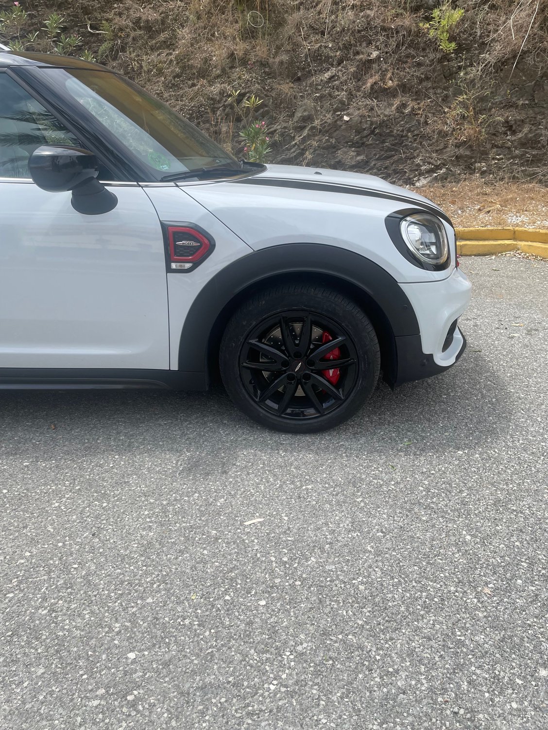

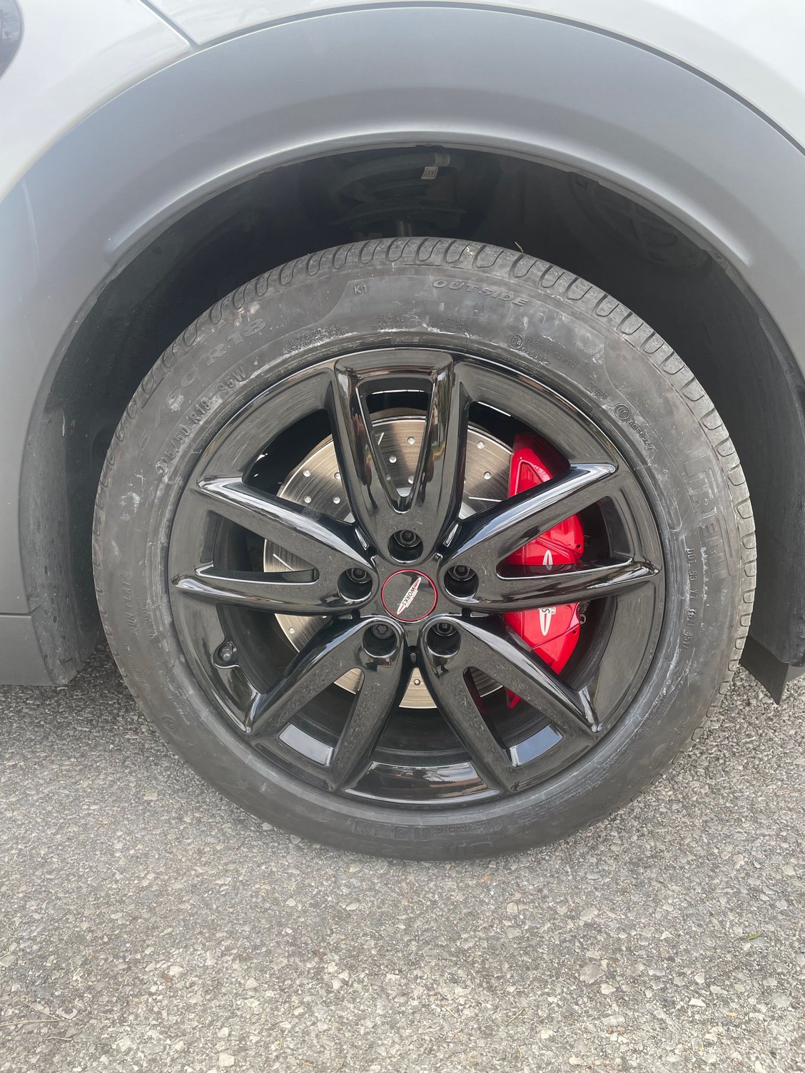

Sure
Side view. The wheels hide the calipers more than I wanted, but tuth is I care more the stopping power than the looks.
Same profile as stock wheels. So if you want them to stick out some, you should not buy the JCW wheels.
Rear calipers.
Front calipers

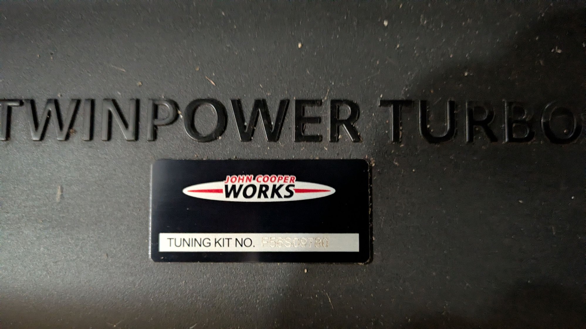

Not sure I mentioned it before, but our F60 has the F57 JCW Tune Kit so proper braking seemed like a good idea. This the main reason for the coding.

you mean F54 don't you? The kit for F56, F57 is not valid for F60
Reply 0
Oct 20, 2025 | 10:52 AM
  #35
Sure, OK. if you say so I don't really know
I cannot speak with any authority about the newer gen 2/3. just the early gen 1's
I do know that the tune plate says F56S09789. so I was just guessing and was wrong F56 not 57.
Reply 0
Oct 21, 2025 | 12:56 PM
  #36
ok jefferson, the brakes are the ones from the F54 kit - it is mentioned above. Regards
Reply 0
Oct 21, 2025 | 01:18 PM
  #37
I think we got crossed up somehow.
Based upon the plaque, I think the tune kit is for an F56.
Based on the description for the brake from ECS:
JCW 4 Piston Sport Brake Kit Retrofit-Priced As Kit F54 & F60
It could be either......
I think you can see my confusion with this conversation.
Either way.....to answer your original question. I had the brakes coded at the dealer.
