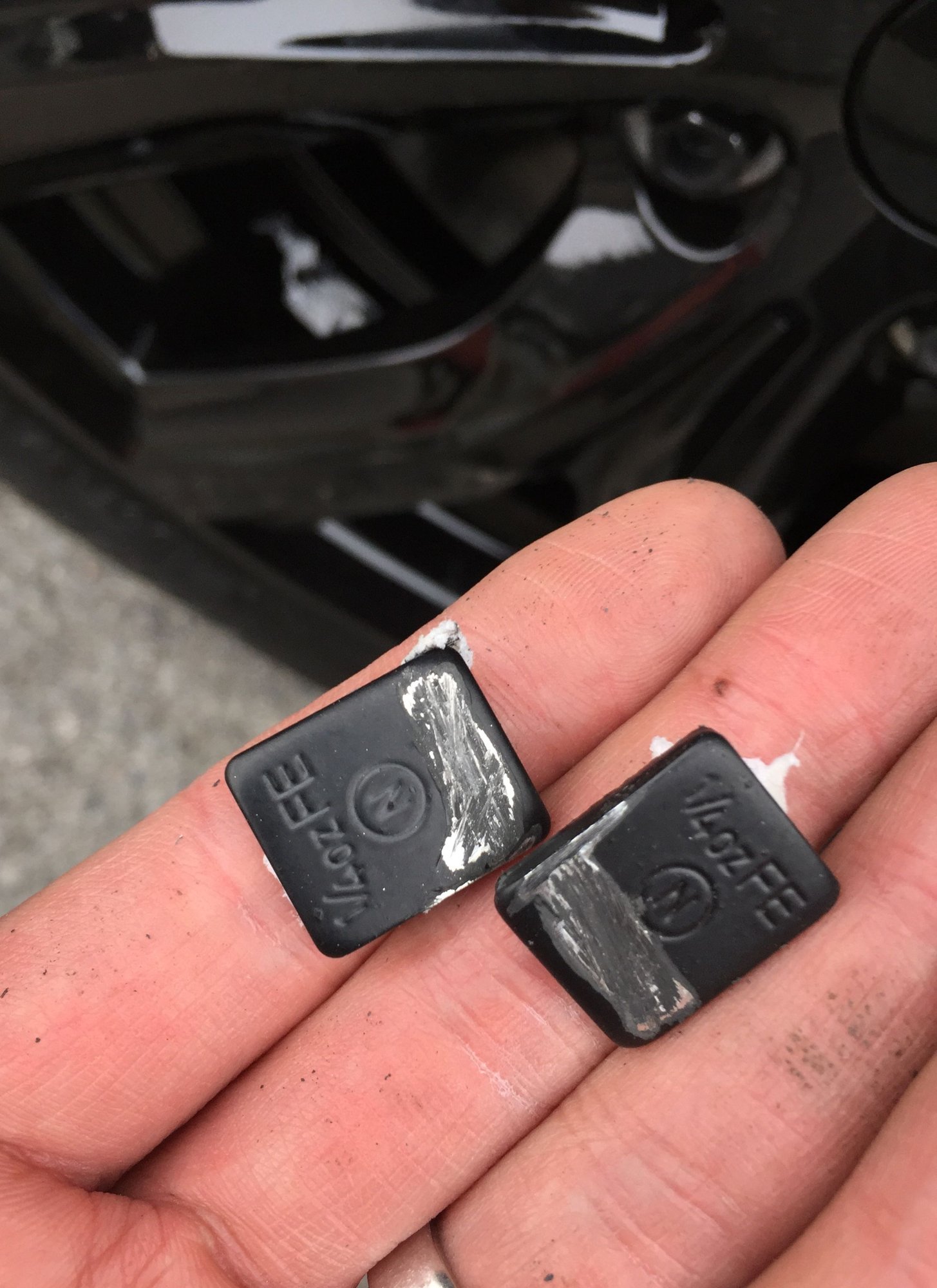

Finally got a chance today to install my winter set. Settled on some Replika wheels:
Black, 225/55 r17, center 66.6, 7.5, offset 47
Blizzaks DM-V2 (none RFL)
Installed was was quick and easy as the fit was perfect until I heard some rubbing when backing out of the garage. Took a quick look and the external weights installed on the wheels was rubbing into the caliper.
Took off the weights and no more rubbing. However now I have both front and back unbalanced wheels . My understanding is that I can get a shop to rebalance the wheels but put the weights in different place. Is that correct?
For those that have used wheels with smaller offset, how did you do it? Should I be asking something specific from the shop to fix this?
Thank you.

Old Dec 2, 2017 | 07:57 PM
Pure Red's Avatar
Pure Red
Joined: Jan 2015
Posts: 366
From: Chicago
Thank you.
Minh
. Exactly as you thought, move the weights further into the inside of the rim to clear those front calipers if possible. Our 17” rims have a stepped inside diameter that gets larger about 3/4” from where I first tried putting wheel weights. I moved and rebalanced all 4 rims as needed since we were hitting first time on the car mounted....
Old Dec 5, 2017 | 08:47 AM
minimtx's Avatar
minimtx
Joined: Jul 2005
Posts: 42
Thanks for the info. Took the car to a tire shop yesterday and they were able to place the weights further back which cleared the calipers. Rebalanced them and no more issue now.
On a side note: whoa.. what a difference riding experience.. much smoother now.
Cheers!
