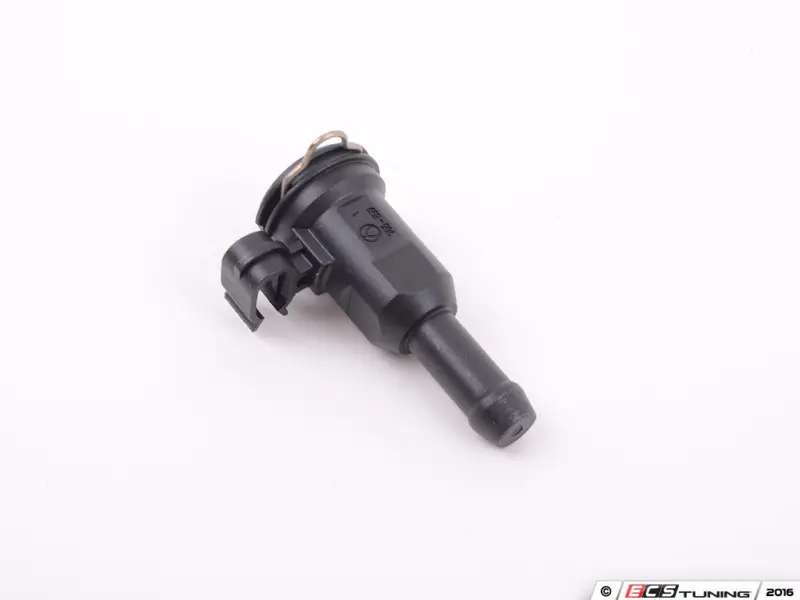

I was just replacing my air filter today, after I put back on the air filter cover I noticed something odd - a small nozzle that looks like it should have a hose attached, and a bracket that looks like it should be holding the missing hose attached to the side of the air filter cover... see the image where I've circled both, the large tubs is the one going into the air filter housing.

Take a look at the end of that fitting. Some Countryman engines had that blocked off. Yours could be one of those engines.
https://www.ecstuning.com/b-genuine-...g/11157618255/
Thanks, looking at that more closely it seems you are right, it looks like the end is blocked off! So I guess that's not the source of my issue.
