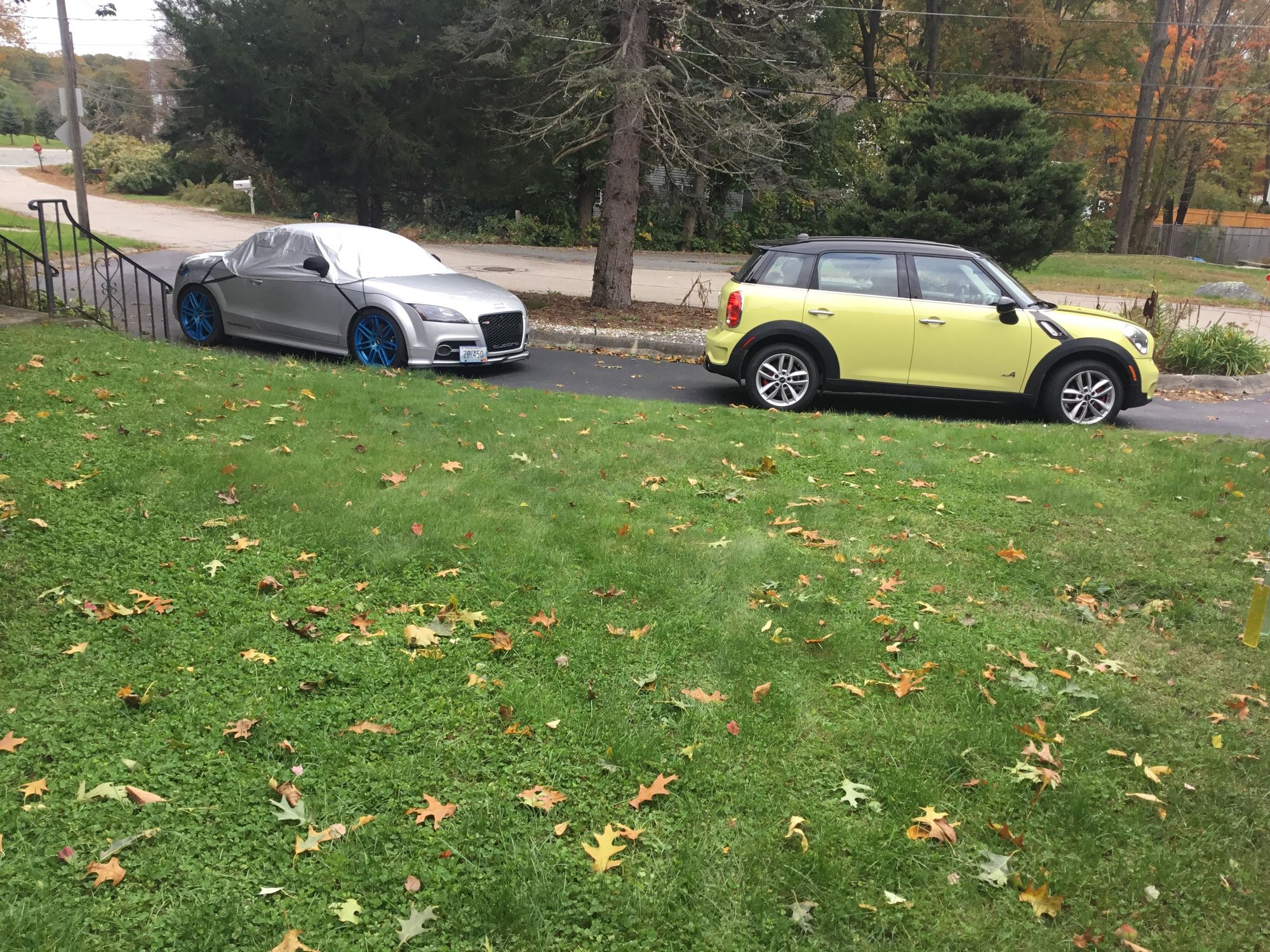

Lots of work done here. It seems that you have avoided the water pump so I’d recommend water temp though having a larger inter cooler is very nice. I would also think about replacing the belts. I’m at 63k and that’s the next thing for me. I’ve got to watch my $$, but I do already have new plugs and ignition coils to install. This is my daily driver so I’m being cautious on upgrades. Baby steps. I’ve got a 2nd car but at 103k miles it’s more of the weekend warrior. Good luck with upgrades as we enter the winter months. How about a couple of pics?

She’s beautiful. I haven’t owned a red car since my 87 super charged mr2 days. I love the darkened windows, which I could do that but limited to just the rear here in New England.
