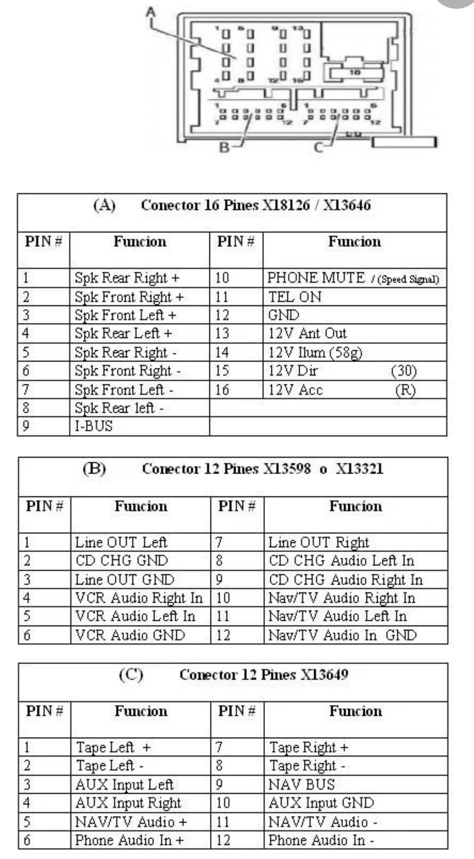

On my cd player large harness, pin 16 is for 12v switched where as pin 15 is for battery. On my 2013 countryman pin 16 looks like it’s missing. Need 12v switched so i can finish my alpine install. Any ideas without routing a new wire from a fuse box?

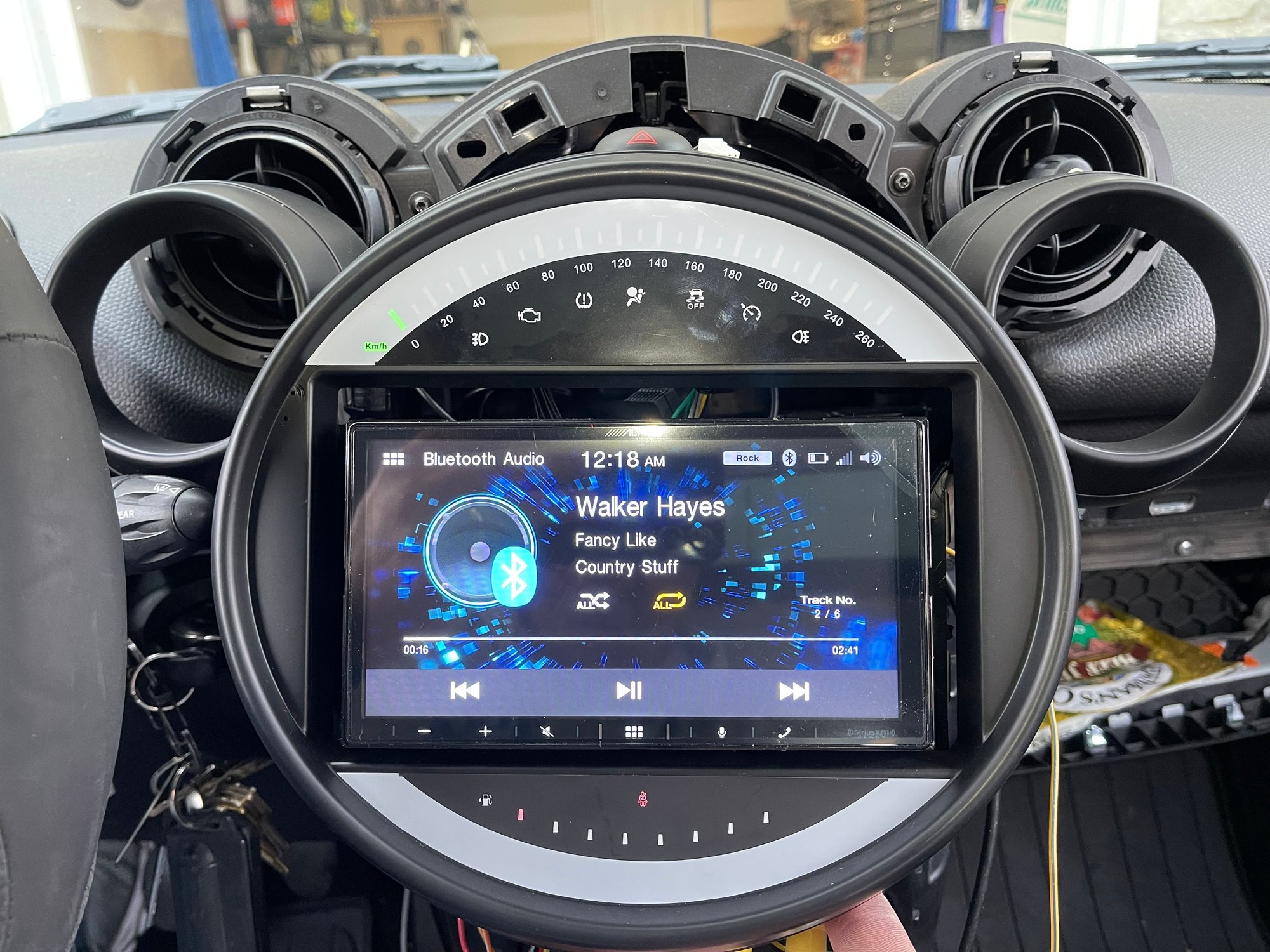

So i figured out the 12v switched wire but my alpine is forgetting its memory which to me says my 12v battery wire on that plug is not constant. Slowly but shirley its getting resolved.
issue is our new Seicane radio was junk and flawed so bad, and their support was pretty lacking so i decided to use their harness to power my Alpine.
ill have sendcutsend make me a trim plate to cover the gap when im done.
