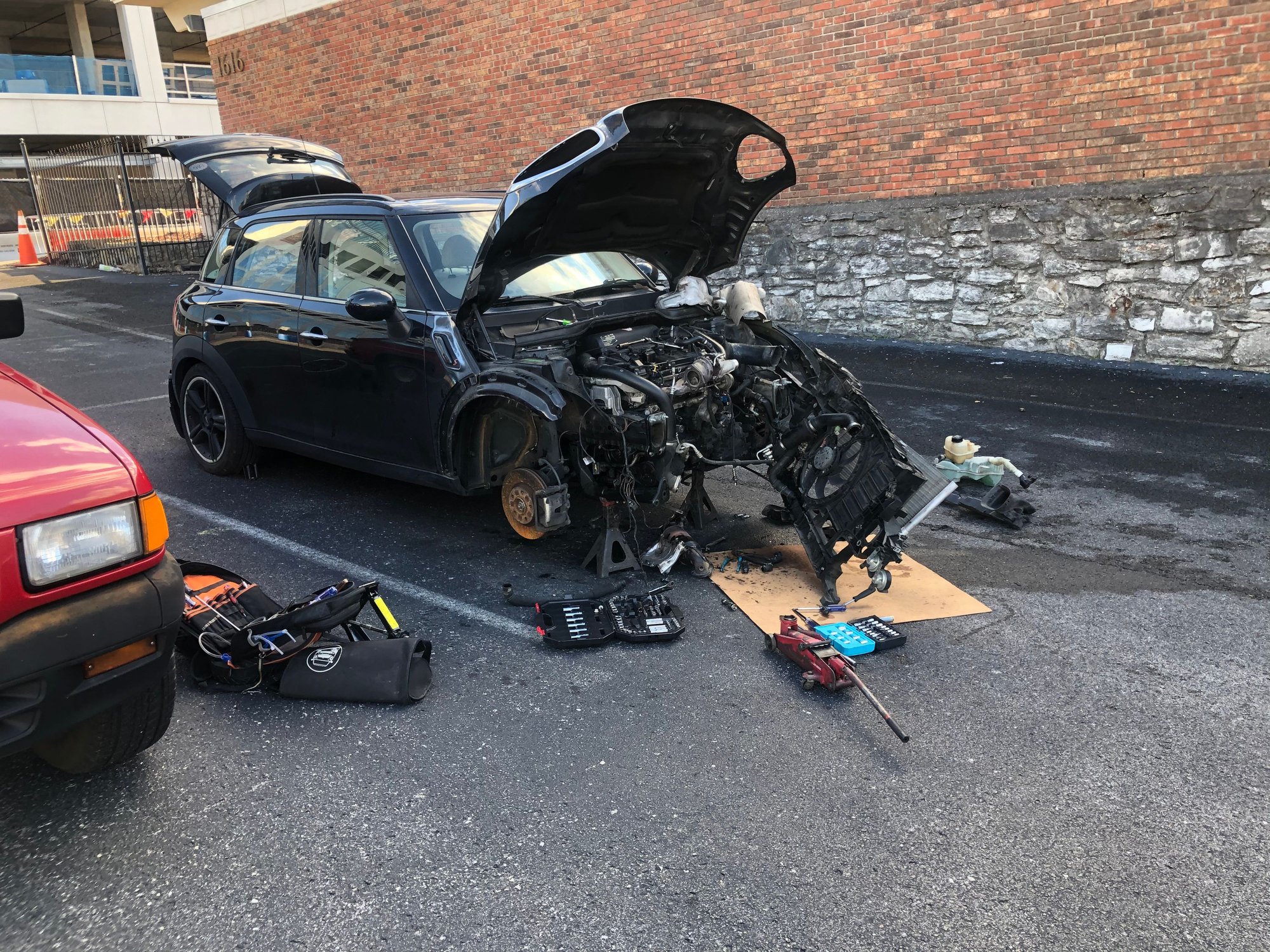

So one morning I am heading into work car does some funky stuff, i make the exit ramp, car dies stopped at next light. Unable to start for about 15 minutes. Get it started limp into my work parking lot. Inspect the engine bay and find the following:
  1. Coolant hose below reservoir blown off
  2. Gas smell in coolant reservoir

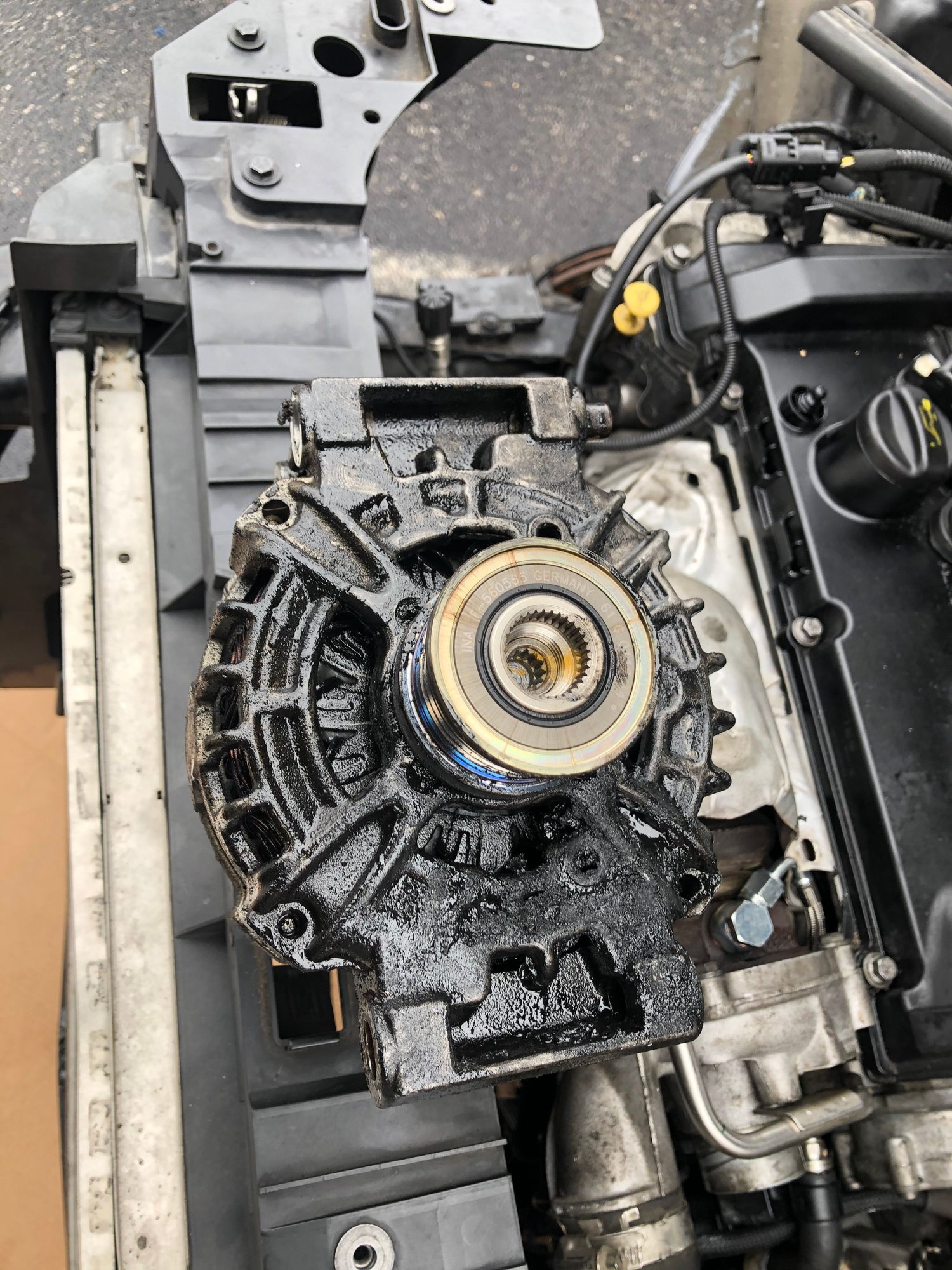

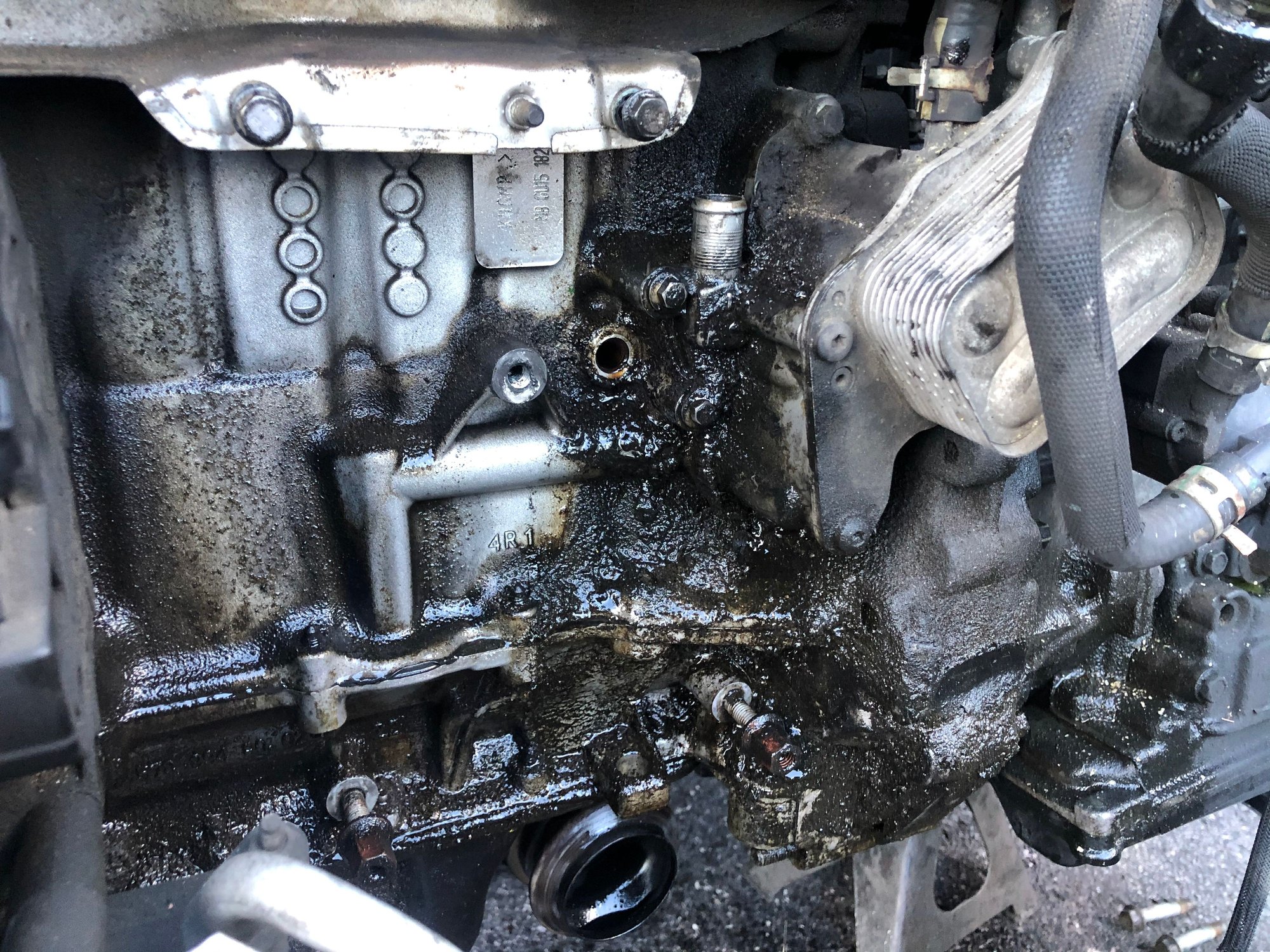

  3. Oil coating everything surrounding the crankshaft pulley. Not a little but ALOT
  4. Crank no start
So due to #2 above i know head gasket blown minimum. I am not a mechanic but can tinker enough to cover the small potatoes. So I quickly delve into google to find all the how-to's i can.
Thank you ErictheCarguy(youtube), Mod Mini(youtube) and milanmastracci(youtube), I have an N18 engine and these guys were the best help.

  • Alternator (this was changed because there was so much oil i was worried for a short and I do not know how to clean it up...yet)

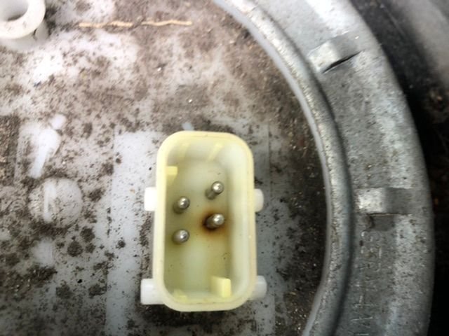

Yesterday I removed the rear passenger seat and gain access to the top of the fuel pump. I do not like what I see
Fuel pump with blackened pin
that pin sure is blackened. I worry because that pump obvious got hot or sparked and its in the fuel tank.
This is where I am at right now I did not open it up until i get a new pump in.

Lots of oil
Even more oil

I applaud you for doing that in the parking lot! How long did the whole procedure take?
Reply 0
Dec 29, 2020 | 07:40 AM
So far i am on week 3 of maybe 2-3 hours of work mon-fri and 5 hours on sat and sun. I had no other option as home is 30+miles away and tow truck would have ate the money for parts.

That blackened pin on the in tank pump.
Does it go down if you press it?
Mine did. The "black" was from fuel leaking out it. Caused a "check gas cap message". I used JB weld marine to fix it.

1. That burnt pin is not loose at all just really burnt
Amazing it did not blow up the gas tank
