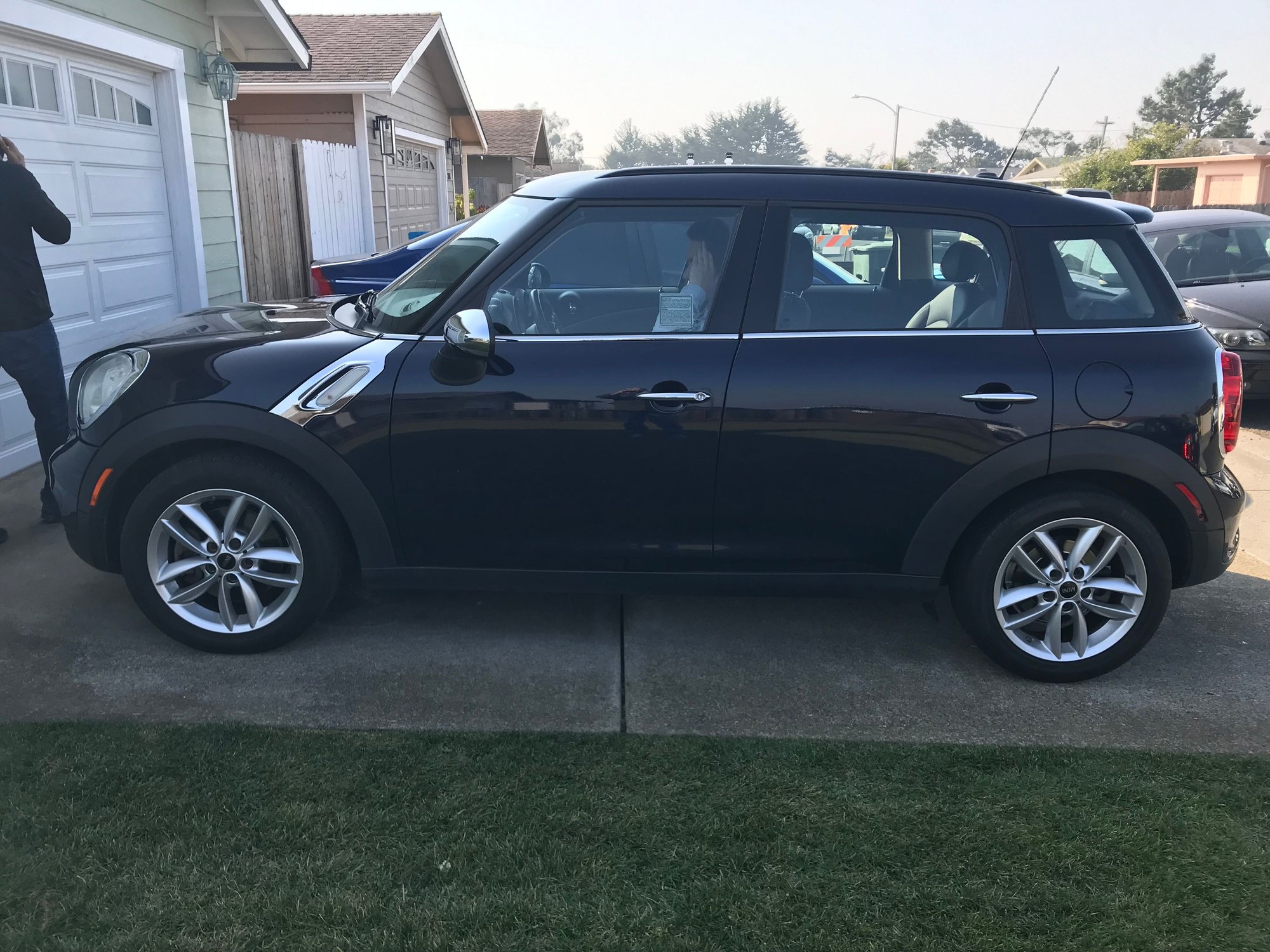

Hello All, 1st post, brand new to the Mini World as of 1 week ago when I purchased a 2011 Countryman S for my son. So far runs like a dream for him, he loves it, and we'll keep our fingers crossed. Previous owner kept the vehicle in excellent condition. I will try to post some pics.
My question concerns mounting new OEM wheels and tires I found on Craigslist from a Countryman owner who only put about 100 miles on them before switching them out for other wheels. I tried the Reset in the owners manual but the car is still showing the yellow inflation caution light in the large center speedometer gauge.

Went from these.....
to these
