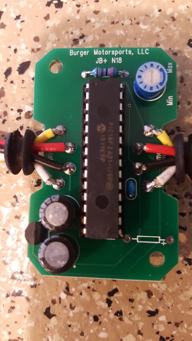

Can you post a picture of it
mQubed Motorsport, Manic Tuning Dealer
Old Sep 11, 2016 | 11:25 AM
RedCountryS's Avatar
RedCountryS
Joined: May 2016
Posts: 13
Hi Mario, I bought it used from a friend, I doubt that it is fake, ill post a picture later when i get home
RedCountryS
Joined: May 2016
Posts: 13
so this is my JB+ I doubt it is fake, maybe its a bad unit, i hope not

This is what I got not looking to good :( Teach me for being a cheapskate
Genuine from the Factory-Front
Genuine-Back nice soldering
Genuine on the left-Back
Genuine on left-Front
Genuine Plug on the left
Ebay Item -Back non factory solder
Ebay item - Front looks like non genuine chipset and missing rubber Grommets

@davers. Im catching up on this thread. Did you buy a knock-off Burger tuner mistakenly?
Old Sep 14, 2016 | 02:15 PM
Davers's Avatar
Davers
Joined: Apr 2016
Posts: 75
Likes: 12
From: Boise
Thought I was getting a deal reported to the seller and ebay and have got a refund coming, this is a first for me on ebay but hopefully the photos might give people a little reference to watch out for
Old Sep 15, 2016 | 03:32 PM
RedCountryS
Joined: May 2016
Posts: 13
wow man, huge thanks for posting this, I will check mine later to see if it is a knock-off, hope not
