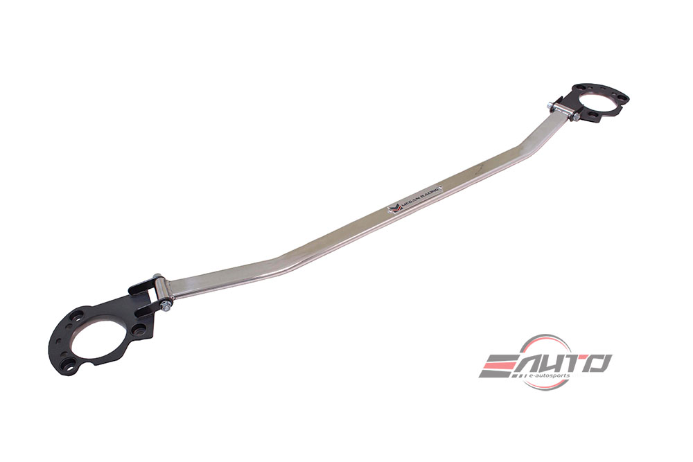

Recently purchased a MEGAN RACE SPEC FRONT UPPER STRUT BAR on eBay for $99 was wondering if any one else installed the same.

I saw the same item and was about to purchase it as well. I was very askance as the price was almost too good to be true, considering other manufacturer's bars sell for $250-300!
I did reach out to Megan Racing and asked them about it since I did not see the bar listed on their website. The rep said that the bar is indeed made by them, however, it is not listed on their website because their website is undergoing updates and changes.
Have you installed it yet? How is the fit & finish, build quality? Also, do you have some sort of aftermarket intake system? I have the NM Engineering kit and was wondering if the strut bar is able to "hover" over the intake without touching?

Did not receive it yet, the only thing I can see by looking at the pictures that may cause a small problem is that on the drivers side theres (3 bolts + an additional screw), I may have to drill a small hole in the strut bar that will go over the additional screw once installed, nothing major for that price.
Should look great and perform as it should.
I will take pictures during the installation next week.
I installed a k&N filter using the original air box, the new strut bar should be high enough according to the pictures.

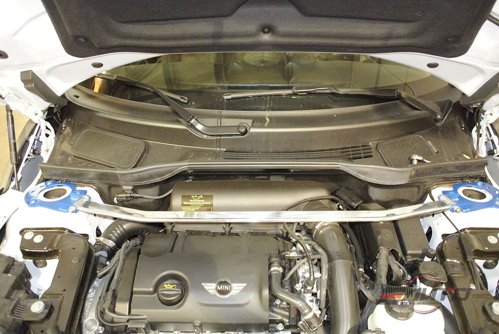

I think this one will be the actual struts bar and I am thinking of buying it myself
Attached Thumbnails Strut bar for my cm on ebay-mr-sb-mcc11fu-1p.jpg   Strut bar for my cm on ebay-mr-sb-mcc11fu-1p_ins.jpg

Your picture seems to be the correct one (the blue looks great, and the extra small holes on each side will fit perfectly), I should be installing the one I ordered next weekend.
Thanks for the info

It seems the actual part number used for my strut bar (MR-SB-MCC11FU-1P) is the same as yours, I then checked their web site (http://www.meganracing.com/products/...=2166&catid=35) and your bar shows up.
I think on eBay (for my purchase) they used the wrong picture.

Keeping my fingers cross (hopping to receive your model), I notice on eBay for my purchase
*Most of the images provided are for illustration purposes only and may not be the actual products.*

I got confirmation from the EBay seller that his picture is a stock picture which does not actually represent the item sold, the correct picture is the one found on the Megan website.

It seems the EBay seller has replaced his picture with the correct one.
