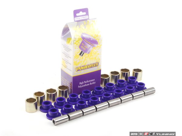

what are pf bushings and what do they do?
Old Jun 4, 2015 | 02:17 PM
Posts: 36,762
Likes: 2,551
Tighten up the suspension in the rear, better feedback , and replace once and your done.
If you have the stock Sway bars , you can do the bushings.
http://www.ecstuning.com/Mini-2011-Cooper_Countryman-R60-S_ALL4-Hatchback-L4_1.6L_N18B16A/Search/SiteSearch/Powerflex/
