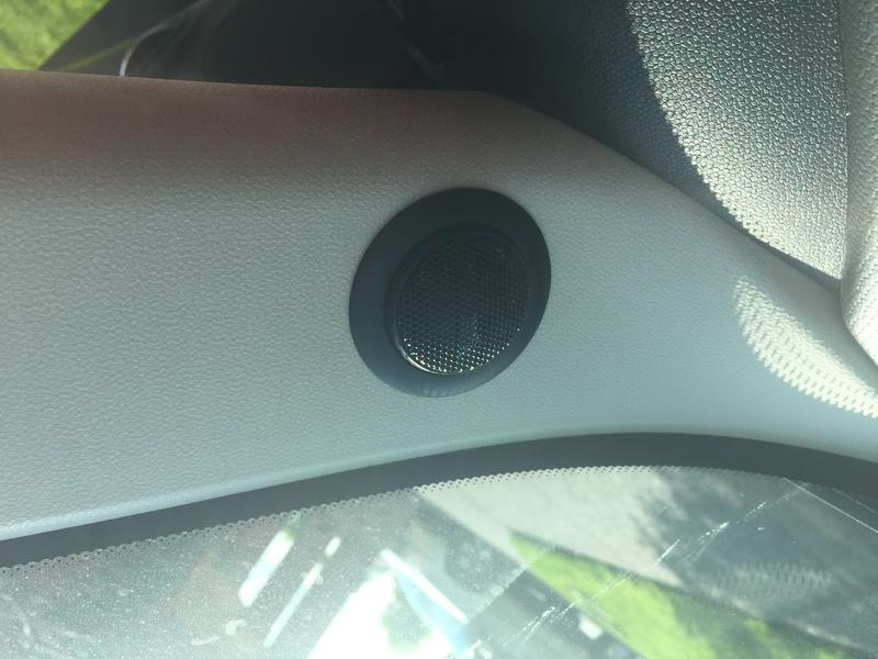

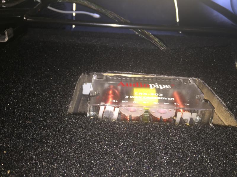

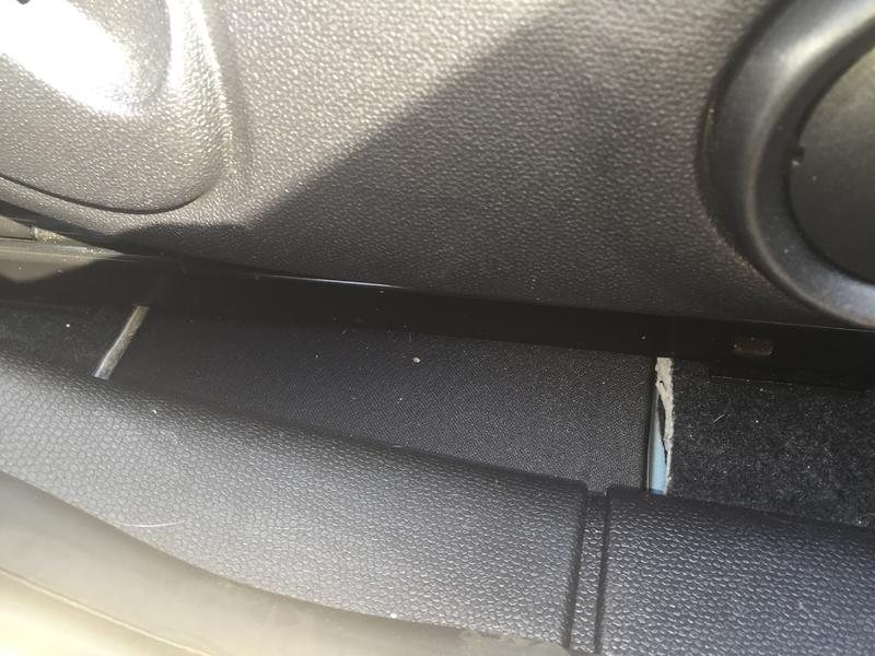

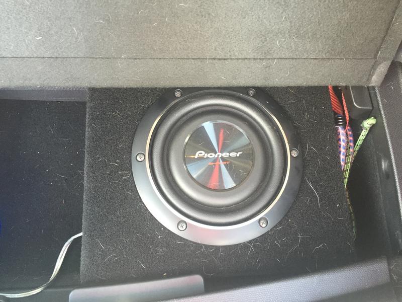

Below are the pictures of the install. Don't mind the dog hair, My dog sits in the cargo area, and he gets Hair EVERYWHERE; the MINI needs a bath badly. Anyway picture one is the signal processing etc, the sub is next to it and it all fits nicely under the flat load floor. 3rd pictures is the 3 way crossover for the front speakers that is under the front seats. I already tor out the stock speakers so i cut a bit more carpet out to mount the crossovers on some MDF. Used box carpet to cover the wood and left about an extra inch to cover up the gap / where I cut the old carpet out. 4th pic is the placement of the tweeter, I got the idea from another thread on here, great thread for advice by the way. The last picture shows the under seat 6.5 with the speaker cloth covering it.
