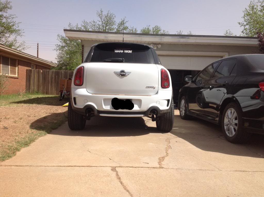

Just installed the mini fini hitch for the countryman looks good and is a permanent solution.
You can barley see it.
http://www.minifini.com
Even have a installation video.A+++++
Good quality welds.
After I installed it.
It's hidden in the area with the black plastic grill.
