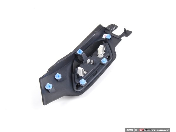

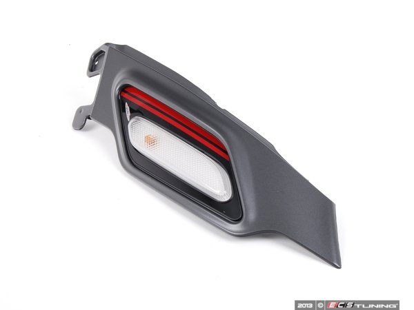

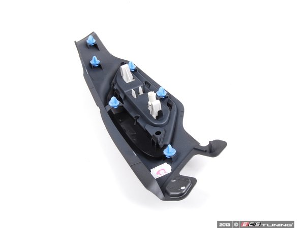

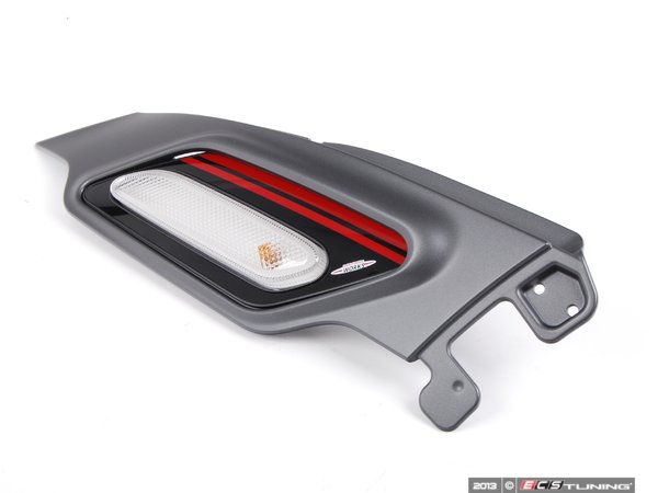

We have the JCW version here which show the backing and scuttle insert. You can see how the insert attaches and he clips that go into the body are mounted / held.
http://www.ecstuning.com/Search/SiteSearch/51139808594/ES2627152/
http://www.ecstuning.com/Search/SiteSearch/51139808593/ES2627151/
Watch the little clips on the back that clip into the main side scuttle trim cover. If you remove the inserts to change them out.
http://www.ecstuning.com/Search/SiteSearch/51132184057/ES2138982/
Hope that helps with the pictures.

I hate to dig up an old post, but does anyone know the name or part number of the clips that hold the scuttles to the car. I started to take my scuttles off but the clips are old and are breaking. I don't want to remove them for paint until I know I can get them back on.
Old Oct 29, 2015 | 05:26 AM
Posts: 36,762
Likes: 2,552
The little blue clips ( seen above ) that hols the side scuttle to the body are here: 51139804996 on the Countryman / Paceman .
https://www.ecstuning.com/Search/SiteSearch/51139804996/
