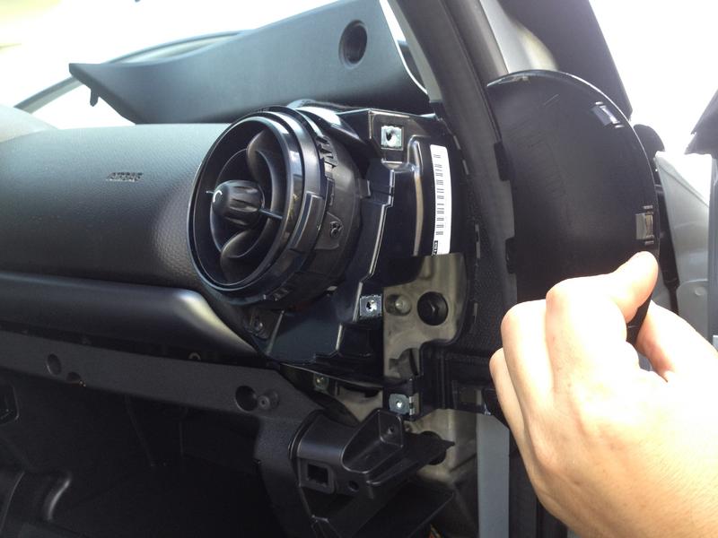

thank you Bmtespar for the help!! i got mickey done yesterday now i have to tackle those side vents again, any info/tips for those would be much appreciated. like what lower dash are you talking about removing, and do you have to do it on the glovebox side? i went with gunmetal to match the accent trim. it should have come this way to begin with. in the picture you can see the side vent is not done yet.

Looks good! Congrats! The side vents are a lot more work. When I am referring to the lower dash, I am referring to the dash trim below the steering wheel just above your knees and on the other side the glove box. The steering wheel sides is just held on at the top by clips which can be poped out on both sides of the steering wheel. The glove box has some screws holding it in place at the top part of the trim when you open the glove box. Neither of these pieces have to be fully removed, just pulled down far enough to access the screw on each part of the vent trim.

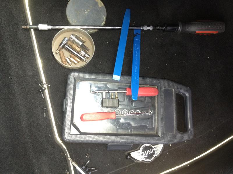

three more picks. Mickey only has clips, so be careful to pop one at a time. inch around with your fingers, once you can get them in there. airbag decal on A-post covers its torks. side and lower panels clips only. torks at top of glove box x3 and passenger x2 side reveals the hidden torks i could not find before. one torks on top and 2 on side and that hidden one on the bottom and walla its off and ready to mask off and paint.
