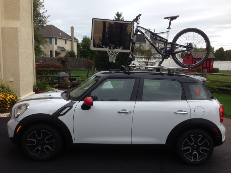

Mounted up my OEM rack with Rockymounts Europitchfork. This is a great setup for my Spesh Stumpy 29er!

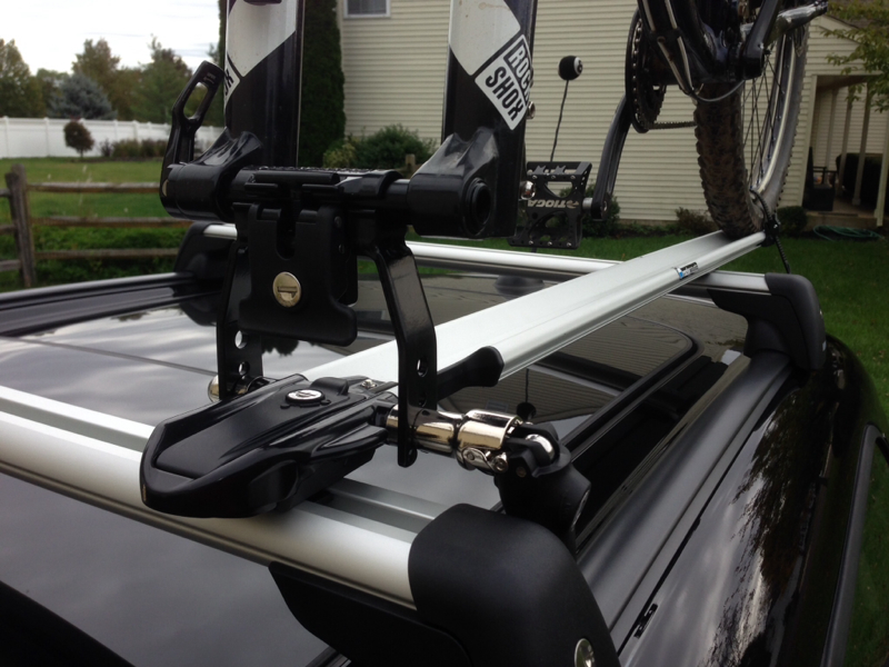

A close up of the Rockymounts Driveshaft that accepts a 20 mm thru axel.

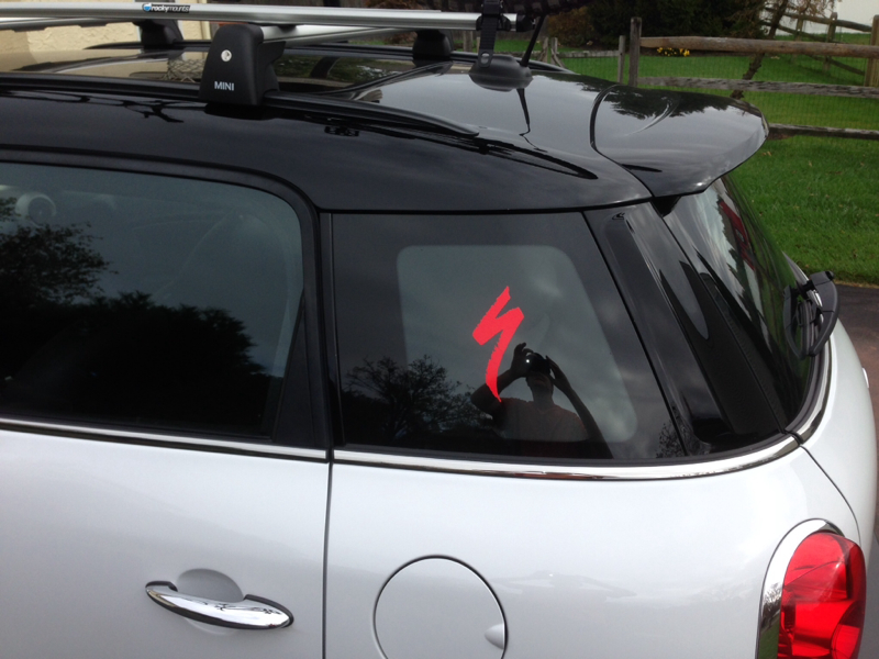

Put a Spesh sticker on the rear window, too!

Rehashing an old one from 2013... Wondering if you have any usage reports/advice on the RM DriveShaft in combination with the Euro Pitchforks?
Graduating to a thru-axle bike, and need this adapter, but have heard some horror stories out there...

Even though we've already discussed via PM, I thought other folks might be interested. The DriveShaft works well. Once the bike is mounted, you do have to be sure to secure the rear wheel with an extra strap to keep the bike from pivoting on the axle fore and aft. I usually move the bike in the forward position and the secure the straps at the back. I just use a Gear Tie I got at Home Depot for the extra wheel strap. Then it's solid.

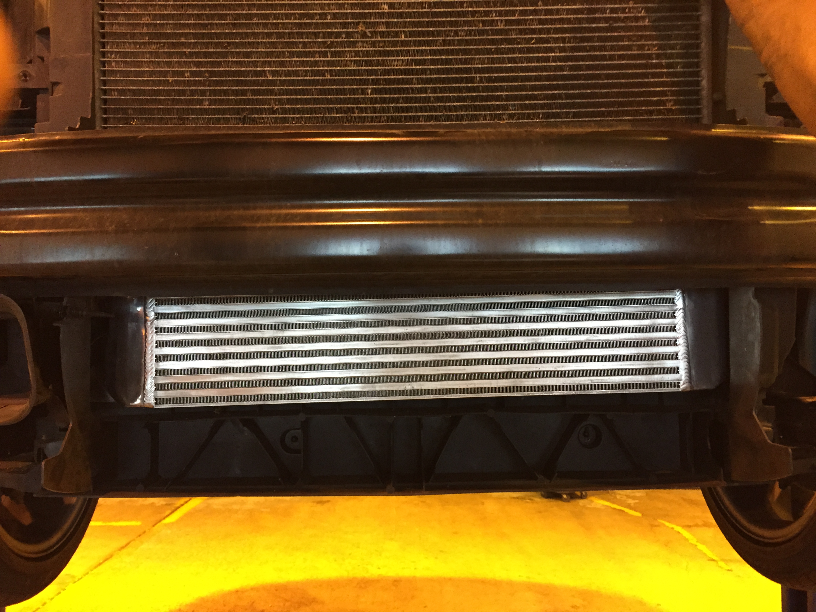

Installed Remus muffler and Helix FMIC....I'll post pics shortly
