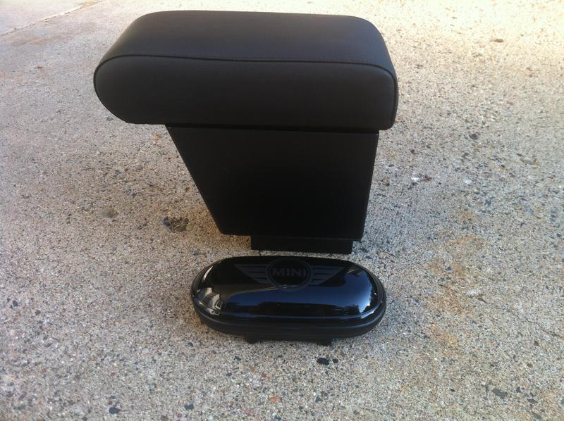

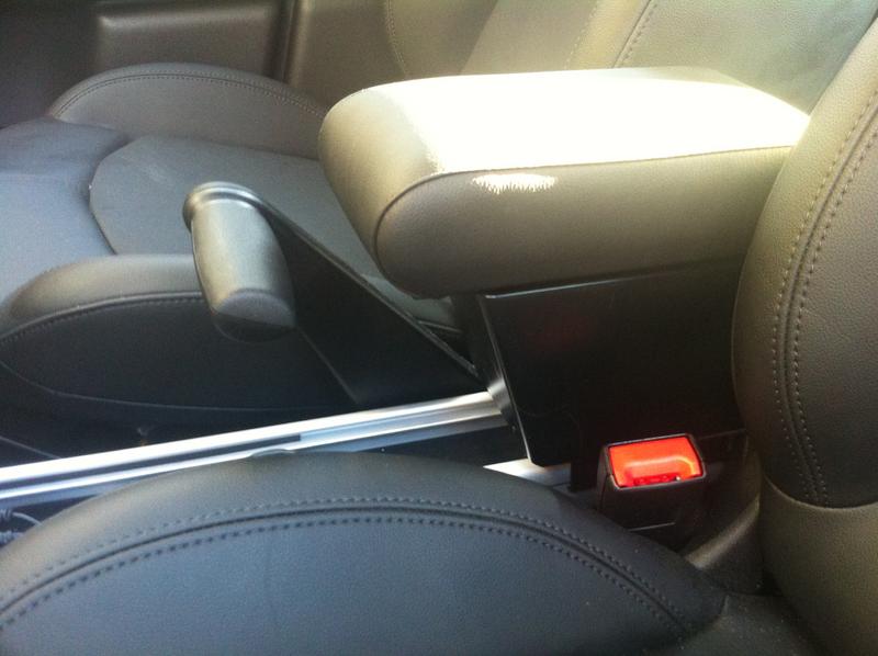

My armrest from Moss Mini finally arrived, it's a pretty nice little unit.
To answer a few questions - #1) the top (padded part) adjusts about 2-3 inches forward. #2) the bottom is not moveable unless you loosen 3 small screws on drivers side of mount and it's limited to travel because of E brake - *Note of caution these 3 screws are very small and strip easily - I had to use longer screws just to tighten to rail.
I also tried it on rear rail and works out pretty good there also. Might be a pain if you drop rear seats often.(Pics attached)
Attached Thumbnails Front Center Arm rest?-photo-1.jpg   Front Center Arm rest?-photo-4.jpg   Front Center Arm rest?-photo-2.jpg

it appears wider than the original armrest. i like it.

Just installed mine and like Mical stated you are going to want to use longer screws than the ones provided to install it. The ones provided do not provide enough bite for the bracket to grab the rail.
Overall a good product. Seriously considering getting one for the back seat.

The armrest is held in place by an L shape bracket on either side. The screws go through 3 holes in the top of the bracket and into the wood base of the armrest. Then the brackets tighten onto the rail with the base of the L grabbing the outside of the rail.
FYI I also placed a small amount of fabric under the armrest and between the brackets so as to protect the rail from scratches.
