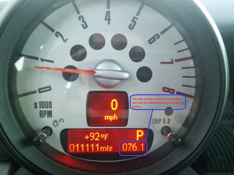

Sorry to revive this 2 year old thread but I am actually having the same exact problem. Took my car in for service over the weekend for a few recalls and they told me they had to "update" the computer on my car. I used to be able to see the trip counter next to the trip button but now it's missing. I can still see the trip counter if i press the trip button but it used to show without me pressing it.

If you have the guts to code your car, I found the coding that brings it back. Took me a few hours of tinkering with the car to find the code to bring it back but it is certainly possible!

I actually bought the cable and read up on coding my car with "video in motion". I spent countless hours in the garage but no luck at all.
