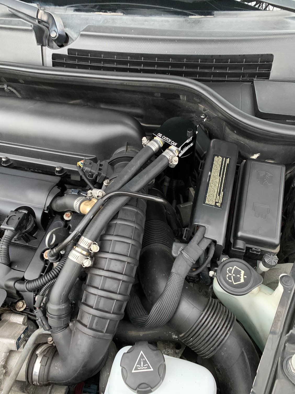

OCC - Oil Catch Can
I have a mod or two done on the performance side, hence why I check it over as much as I do.

That sounds like a lot of blow by...is that normal with these engines?

the n14 is known to burn some oil. When I was letting the car warm up I was collecting a lot more than now, I’m not letting it run for 5 to 10 minutes before driving and this has cut it down by more than half. I have the pcv blocked off on passenger side that runs to intake manifold, and occ on the other side. So I have been running this for 4000 trouble free miles and it’s my way to make sure everything is still good.

From what I understand, this is the N18 engine. This doesn't burn oil like the N14, does it?
Just be careful not to have too much crankcase pressure, or it could blow the pan off..

she’ll be fine, cutting down on oil on intake valves. No cel and I drive her hard. Did 2 trips down to the the dragon the last 2 weekends. Burned a qt of oil, caught 1/4 qt oil/gas mix in can. There was a lot of high revs on the dragon due to only being in 2nd and third gears. 85 to 110 mph on way home for 4.5 hours with an occasional stop to pee, wife and daughter have baby bladders. My mini loves to drive, it glides at 85 plus, wife was surprised when we hit 110, she Was amazed how smooth it was and that it got there so quick.
