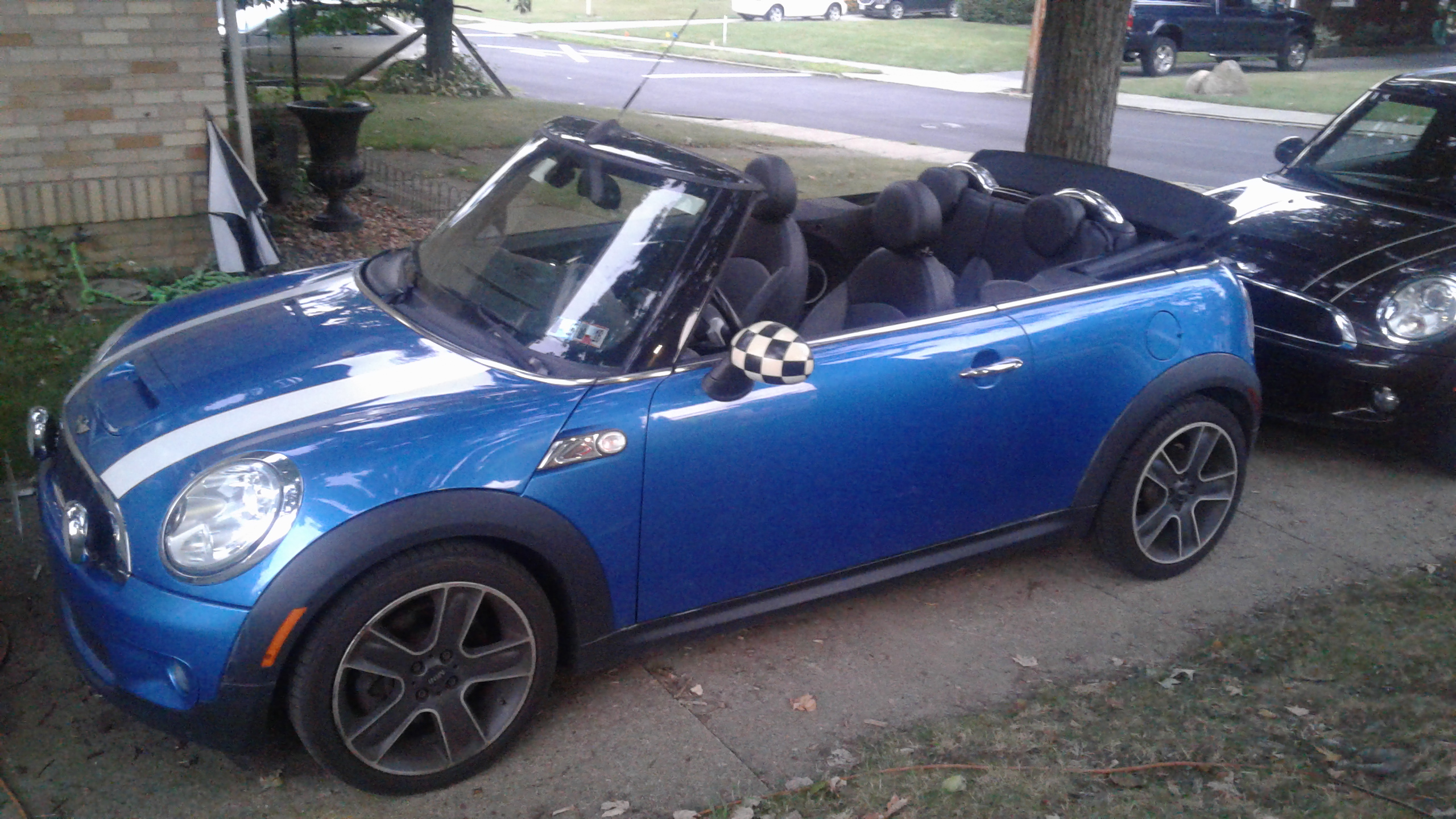

Speaking of that, here is the Princess, top down and ready to roll.
