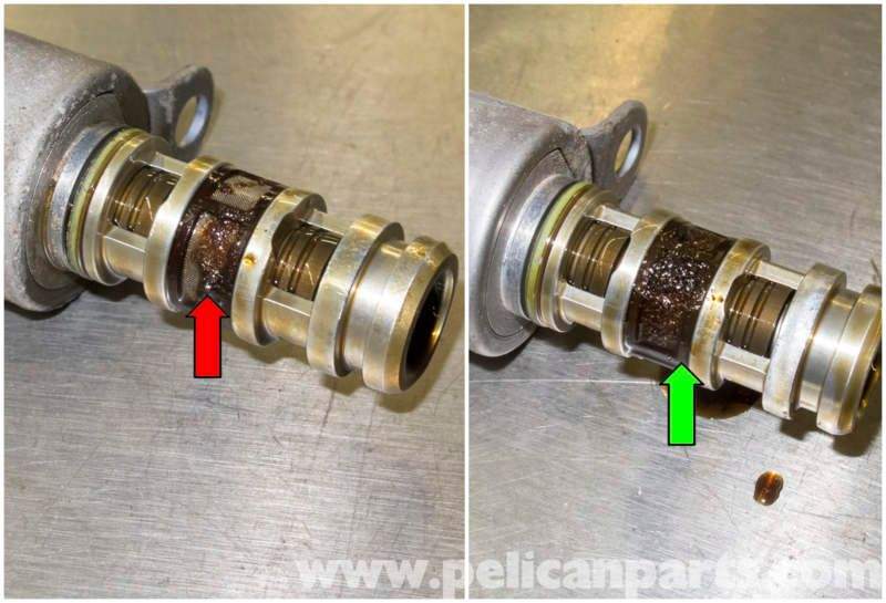

You can clean or replace the solenoid quite easily if needed. My suggestion is if you have determined you need a VANOS solenoid by cleaning, they are fairly inexpensive, and you're always better off replacing a degrading part. We have them here if needed. We also have a DIY that goes over the replacement with a lot of information if needed.

I cleaned the solenoids as one of the first things I did early in this saga. I checked them again and they still look good. Clean and the shuttle moved back and forth smoothly. Both checked out @ E: 8.2 ohms In: 8.6 ohms. How do I check to see if the solenoid are good? I'm not getting a code other than p0301. My concern is that this is a different upstream problem. I have read that replacing solenoids often do not fix the problem.
