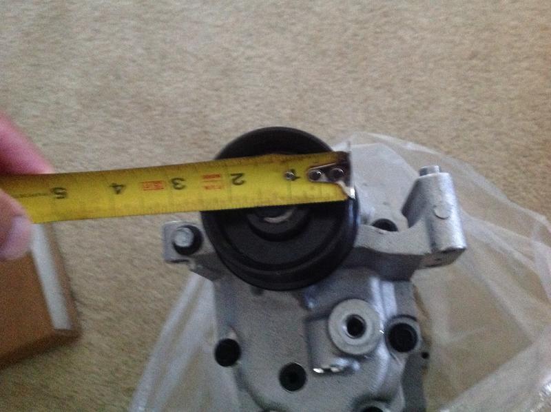

BTW: This is the picture of the new SC Pulley that i am trying to remove! JCW according to the seller, inside its black coated-turbine/whatever you call...shaft etc, so those familiar with this should know if its the 5th Generation Supercharger.

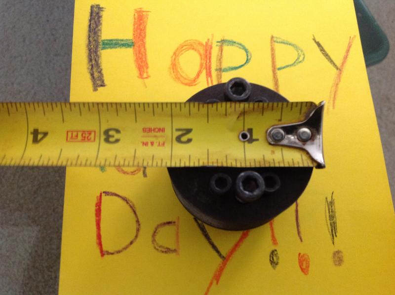

Here is picture of the 02 Helix 15% pulley-diameter 2 1/8".
Planning to install to the new SC?

save money and time, cut the JCW pulley off. your going to break the pulley puller, and then cut the pulley off anyway.
even the dealer (mini of orlando) broke their puller when they did mine.

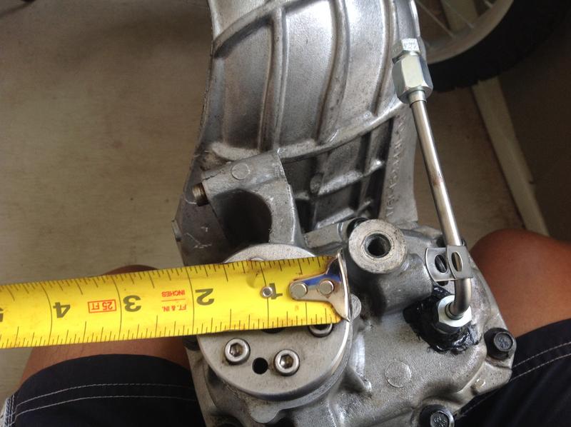

Here is the picture of the 19% pulley that its in the old SC...2 inches exactly.
I appreciate all the input/comments i went to 2 machine shop...refused not taking any chances.
Again thank you for your input.
The picture is the old SC that PTO seal leaks almost dry-out. I was going to reinstall it as you notice i modified the drain plug with refilling tube!
Attached Thumbnails Which S/C pulleypuller work best-image.jpg

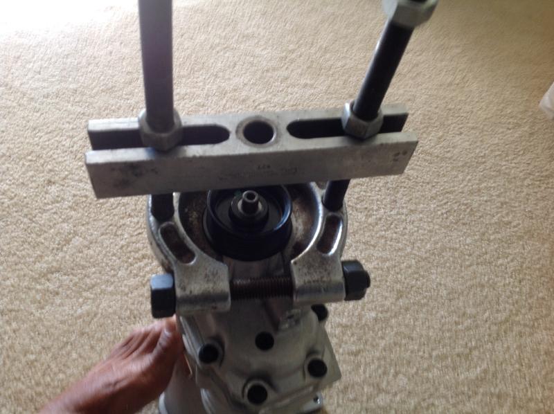

This is my last attemp... Otherwise it will go in tomorrow, waiting for the Belt Tensioner that causes the Engine to overheat due to lack of water circulation (belt skipping)!
Judges... Let me know if this works, maybe add a little heat hopefully it will give and comes out...

Second picture
Update::: Using the clam-shell puller----useless and eneded up cutting and grinding it... best tools to cut.... kneumatic wheel cutter.
