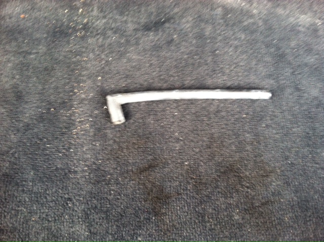

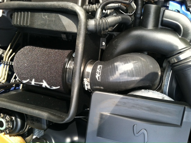

No.1 When I got home I found this small hose in the trunk. I would do a search for it, but not sure what to call it. I presume it could be a vacuume line. Maybe it could have been a hose that went with the OEM air-filter housing... it came to me with an ALTA CAI.
Do you recognize this hose? Where might it belong?

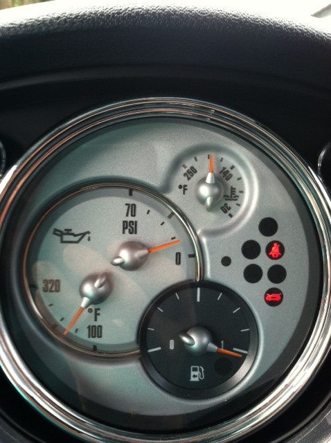

No.2 After I got home, I turned the A/C on high and let it run at idle for about 10 minutes. I notice the cooling fan coming on and off periodically, so that's good. The water temp needle seems to hold steady, just a needle width below the middle mark (as in pic attached) I turned off A/C, gave it a few more minutes at idle and the water temp needle ran up to just a needle width above the middle mark. Gently pulled out of the driveway, and temp was back to normal before the end of the block. Is this 100% normal behaviour, or is that a spike that is higher than you see in a drive through or heavy stop and go traffic?
No.3 Oil Pressure. I assume it is normal that oil pressure would dip this low (15 psi) at idle. It comes up to just below the middle mark (35 psi) by aprox 2000 RPM, and it will go much higher (maybe 50 psi) with a quick stab of the throttle or sustaining an RPM above 4500 or so.
This is normal too right?

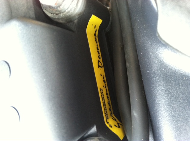

I notice also this Screamin Deamon sticker on the ingnition

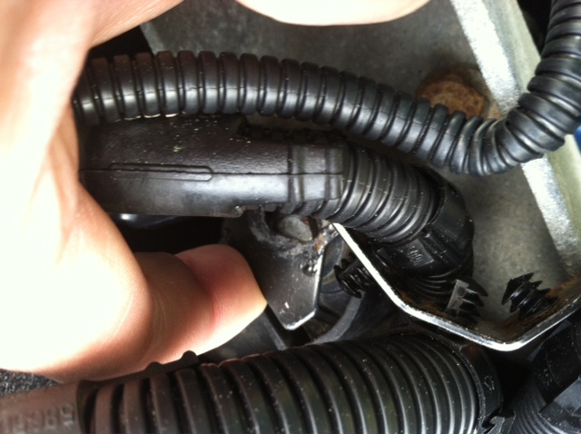

I see this wire harnes near left front motor mount is not attached, probably not urgent though.
Its hard to say but that look like a battery vent tube IMO.
This all sounds normal. The fan will normally come on at 220 degrees or if you turn the AC on it will kick in sooner.
Oil pressure: the oil pump is driven by the engine, therefore oil pressure will increase or decrease directly with engine rpm. The higher the engine rpm, the higher the oil pressure. As you rev the engine, you will should see the gauge fluctuate. That is all normal and is how the oil pump works. The engine will have higher oil pressure when the oil is cold and thick and the pressure will drop some when the oil is hot and thin. All normal.
