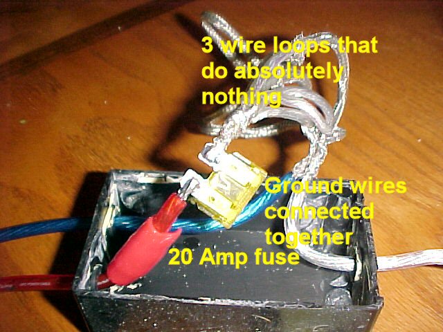

This 350Z owner took apart a $250 performance add on only to find a 20 amp fuse soldered to wires inside. I was going to post a link to the 350Z thread but you need member ship. I will qoute it here and post pics here same info as the 350Z board.

1) Voltage measurements at the + post on the battery with the engine running with and without the DPS.
Voltages remained constant with no discernable change.
2) Next I tested with a Fluke brand portable Oscilloscope to measure frequency variations with the engine running with and without the DPS.
There was no noticeable difference noted on oscilloscope
3) Test drove the car 5 minutes without and approx 45 minutes total with the DPS.
No noticeable change in acceleration, idle or smoothness during the test drive.
4) I repeated these tests on my car without the supercharger belt connected.
Results were the same.
5) Next, I completed the same tests on zand02max's car.
The next thing I did was hook up my 13.8V 20W variable voltage power supply. I took measurements at 10V 12V 13V and 13.5V with an oscilloscope and a multimeter.
6) Measured 10V with and without DPS unit.
No load was put on the power supply, no voltage change, no frequncy changes noted.
6) Same test @ 12V
Same results
7) Same test @ 13V
Same results
Same test @ 13.5V
Same results
So as you can see my results were inconclusive. I was not able to detect the DPS doing much of anything.
At this point I was frustrated. WTH is going on!?! Surely this box must do something, I mean it costs $250 plus shipping. I wanted to open the box up so I could trace out the circuit so I could know what I should be testing for.
Screw it, I opened the box up.
First barrier: The lid was securely epoxied in place. So I took a small drill and drilled holes at strategic points and was careful not to damage any circuitry inside by pushing the drill in to far. Finally pried the lid off and I saw my next barrier. 5 minutes work
Second barrier: When I opened the box, I found the box was filled with what looked like an opaque beige fiberglass resin. I chipped through that to come to my next barrier. 10 minutes work
Third barrier: Obviously they don't want me looking in this thing. Next barrier was easier, but I couldn't figure out why it was there. I'll come back to that later. Beneath the resin there was what looked like a mass of metal tape. Sure enough I found the electronics were double wrapped in metal foil tape. I removed that. 1 minute work.
I don't know if I should give away the secret to the DPS system and what it actually does.

Edit: BTW, I can tell you conclusively what this thing does thanks to a years worth of electronics training courtesy of the US Army.
Well, a few posts later he spilled the beans....basically the box contains an automotive 12volt 30amp fuse which is wired to a male/female connector (pass thru style much like the edge ez).
Talk about some ****** off customers...

Heres a couple pics:

>>Props to Peter for not only having ***** enough to tell people to dive into his product to see that it was legitimate or not, but having sense of humor about the whole thing.
>>Two good qualities.
You are quite right Greatbear. On a related note, it's suprising when people have challenged him on-line, Peter says to call him on the phone. I've spoken to Peter on the phone about possible participation in A Mini Vacation In Vegas and can say he's a good guy. I hope he does come out to Vegas to meet and greet with MINI people.
>>Two good qualities.
>>Maybe someone should open or xray the PB?
>>Maybe the writing on the PB cover should read:
>>Technology Unit (for) Radical(s)
>>Ah but does the DPS have pretty lights? Maybe the fuse has special mind control properties that forces the driver to think that the 350Z is really a fast MINI?
>>Oh well. You only live once. Can I sell you some used "sea monkeys"?? :smile:
