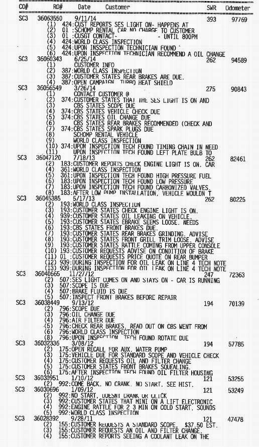

A MINI dealer should be able to provide a DCS report which shows warranty and service plan work. They cannot however provide any customer paid repair orders. Releasing those would require written permission from the previous owner.
The sales guy was persuasive and convinced the Mini dealer to just white out the customer names. They whited out a lot of details as well. But what I can see is that it has been repeatedly in for SES light on and oil leaks, most recently just a few months and 3000 miles ago. So...should I stay far away from this car, or is it pretty much par for the course and I should be glad all this has already happened?
Anyway, here's what I got. Maybe someone more knowledgeable can explain all this? If I'm reading it right...
- 9/11/14 Something was found at the most recent "world class inspection". It doesn't say what, or if it was fixed. That was about 3K miles ago.
- 3/26/14 Timing chain problems found at ~90K miles. Doesn't say if this was addressed, either, but I assume so or it would've died by now.
- 7/18/13 HPFP likely replaced
- 3/8/12 Auxiliary water pump replaced (is this the one that's problematic?)
- 1/9/12 Death rattle led to engine failure ~53K miles. Engine was probably replaced.
