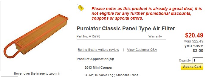

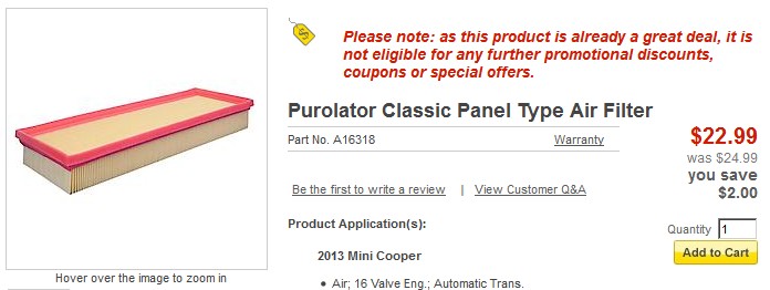

I ordered an air filter from MANN, and received the wrong part, even though the part number for my MINI appears to be correct.
Here's my dilemma.
engine.JPG is a picture of my engine. 1.6 NON-Turbo, Manual Transmission
Image 01: Is the filter for the automatic version, which appears to match
Image 02: Is the part I received for my manual transmission and doesn't appear to be a match (seems long)
Is there a reason why my MINI appears to have the automatic air-filter box despite being manual shift?
I'm really confused here, and can't figure out what part number to order.
Can someone help shed some light on this?

In Europe the MINI (Non S ) engine (2007+) N12 & N16 has two different air filters, one for the manual and one for the automatics.
In the US we just have one type airbox for both. Lots of sites have it wrong.
We have it here> follow part # 13717561235 We have Mann, MINI, AFE, and K&N.

Oh, and lots of sites have the Justa Cooper manual trans air filter part number wrong, many of them. I had to order twice as well, should have just ordered from ECS the first time and saved myself the aggro
