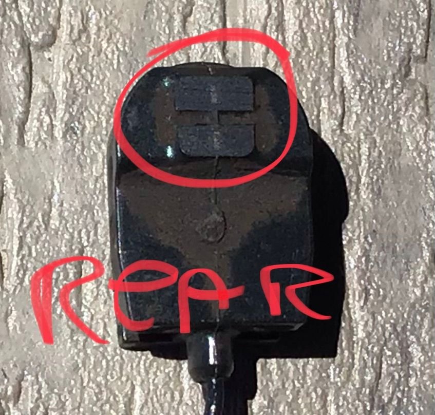

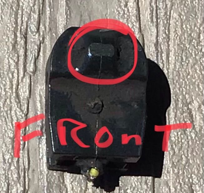

my 2019 Cooper has 15k. Last week it threw the ‘Brake sensor’ light. I had 100K on my 2007 that I sold in November 2018, I had done several brake jobs & feel comfortable in DIY. Over that couse of 100K I learned the rear brake pads last a Lot longer than the fronts.
so when my 2019 threw that sensor light at 15K - here it starts again😉 got on line, ordered front sensors & Pads (somehow I thought they one on each wheel? Pulled front wheels, learned only 1 sensor - however, I started with front right (no sensor). Pulled left, saw where sensor had only a slight amount of wear?? However, I know it does not take much to break that ‘wire’. Pads were worn but still ‘meat’
changed pads, insralled new Sensor. All done - went to reset dash light.... “Failed”
got on the internet - lots of chatter about Failed Resets & Lots of posts on what to do. Spent the next day - doing all suggested. Still, Fail?? Took old sensor and cut off worn sensor and twisted wires together - Old trick to bypass sensor😉 Installed that and still “Fail”
SOB😉
light bulb in my head finally said - Check rear??
first went and found cut off old sensor - got out my multi meater to check ‘Continuity’ It was GOOD?? Worn slightly but evidently not enought - Oh well.
so, back right wheel OFF - pulled sensor - More wear than front - Pads looked the same?? Got multi meeter - that sensor tested ‘BAD’
well what do ya know.
NEVER would I have thought the REAR sensor would wear thru Before the Front.
love my Mini but like my 2007 - Hate the brakes..
here are 2 pictures.

I went back and read my post - guess I did not make ir clear to you.
from past experience, front usually wears faster - changed front pads due to wear on sensor. Would Not reset -
pulled and looked at rear - that sensor was much More worn - That was the problem. Sense I did Not have new rear pads or new rear sensor. I CUT the rear semsor off and tirped the wire together - Faking a new aensor. System Reset just fine.
so, front pad sensor starting to wear but NOT enough to show Light. Rear pad sensor wore enough to show light.
I have those pads and sensor on order, die to arrive tomorrow.
called froend at Mini service. He told me it is common to have sensor wear to throw light at 20k

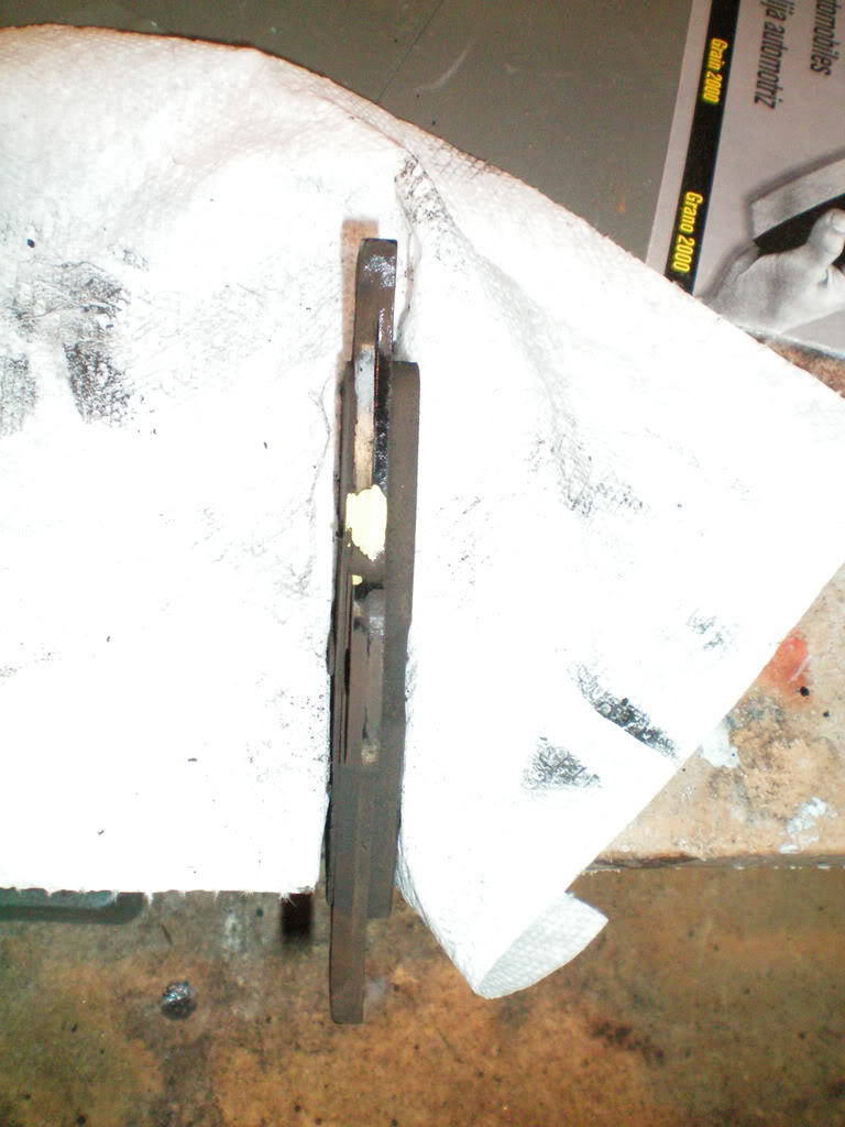

here's a nearly new MINI pad with some white added to the backing plate so ya can visualize . . .
notice the thickness versus the backing plate AND on this OE pad, the bevel .... note that the end on the bevel is where the thickness MATCHES the thickness of the backing plate ......
Here's a worn MINI pad
note thickness of pad versus backing plate .... EASY to see on a qwik eyeball check
also note for this OE pad (and many aftermarkets) the bevel is no longer visible ..... also an EASY eyeball check
