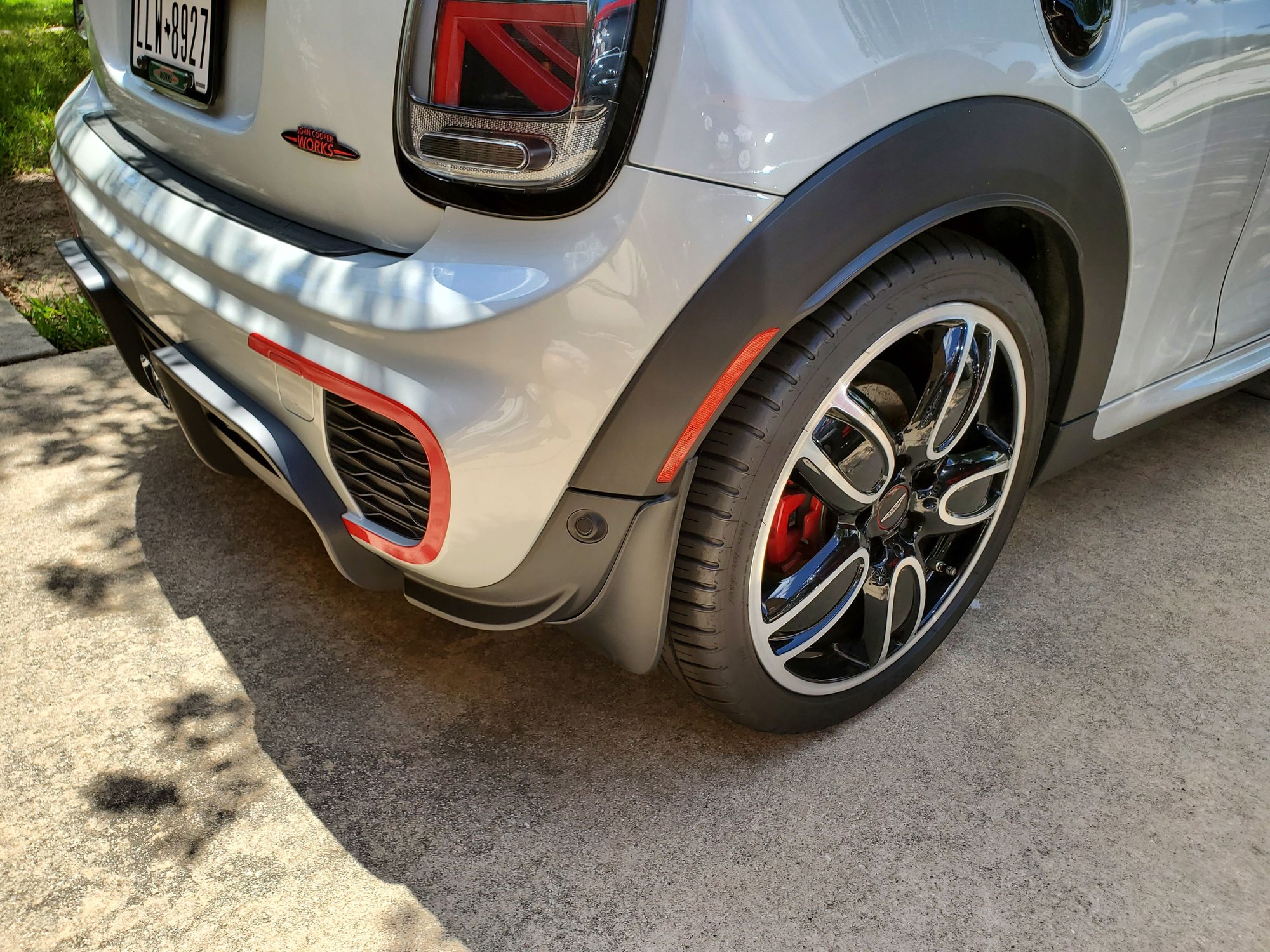

I replaced my 205 RFs with 215 Michelins. The 205s looked stretched on the rim, the 215s appear to be what should have come from the factory. You maybe able to see in this pic how the tire give some rim protection while filling out the rim and making the tire more straight up and down as it should be for flex.
