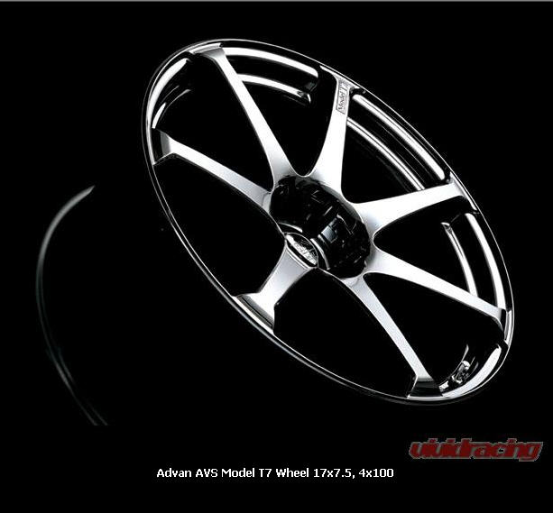

The Advan AVS series of wheels have a lot of clearance.
I have the T7 model and they clear my Wilwood BBK by a lot. They are a 41 offset.
I think they would clear the Brembo calipers, & I think they are about as big as they come for a MINI.
But you better stay away from curbs.
Bill
