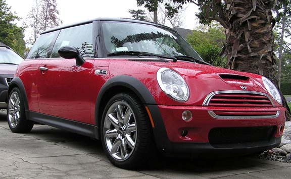

Chrome S-Lites
These were on my MINI when I bought it used. They are chromed. I have seen polished ones as well and they are a little duller in finish and a little more satiny in appearance depending upon the polishing technique. Chrome seems a bit easier to keep clean. We also have chromed stock rims on my wife's Honda S2000, courtesy of the dealer.
By the way, the S-Lites are for sale if you are interested.
