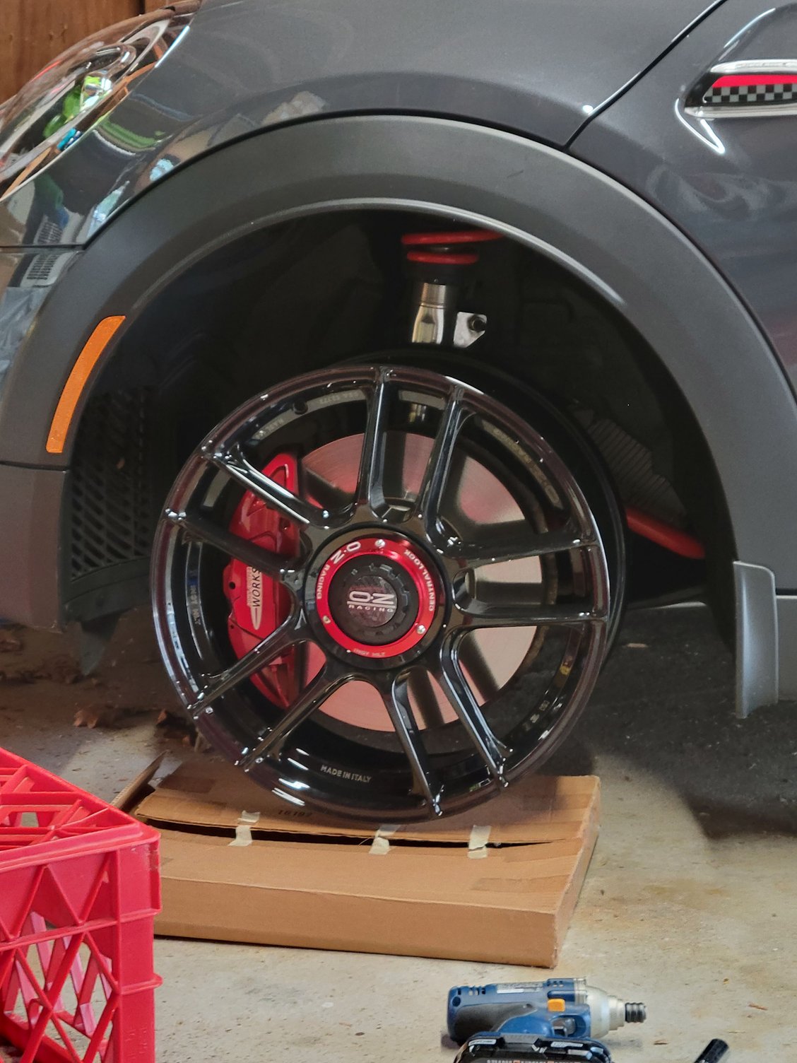

Test fitted 18x8 45et O.Z. Indy Wheel, no tire, only checking wheel clearances.
Front wheel to strut = 5mm clearance (factory 6mm) JCW pro strut dia at flat section = 48.11mm
Front wheel spokes to Brembo = 4mm (factory 5mm)
There's plenty of clearance from the brake pad clip to the inside of the rim for a wheel weight, well over 10mm.
Wheel weight 22lbs, cap 4.8 O.Z. pun intended Looks to me like these work.
5mm
10mm plus
4mm
O.Z. Indy gloss black
front poke
with cap
