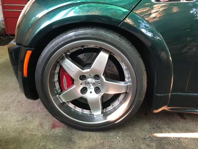

Hello all. I just put a set of 17" Hamann HM4's on our R53 and wanted to let you all know they will clear the 316mm JCW brakes using a 8mm spacer. I would and probably will use a 10mm spacer just for a few extra mm of clearance. just thought I would put it out there.

I used to have a set of those, they have a great old school look, but heavy as hell

You are correct they definitely aren't lite but offer a great look.
