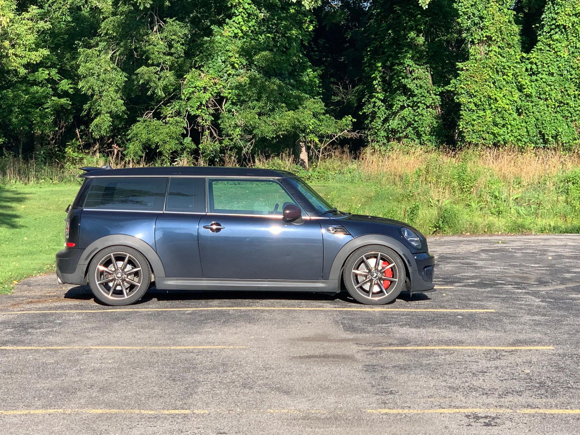

Love the wheels! Minor vibration > 70 mph... Trouble checked all bolts were torqued down to 103 lb-ft Probably due to wheels not balancing correctly? One more trip to mechanic to get them corrected.
look great! Love the dark silver vs white silver contrast!

Oh YEAH!!! Looks fantastic! Need to go get some better pictures out in the wild.
100 ft-lbs torque sounds high. I set my torque wrench to 90 ft-lbs. When I mount my wheels to the car, I use my 1/2" ratchet and spin the lugs in just enough (criss cross pattern) to seat the wheel, then torque once the car is on the ground. Its "possible" the tires didn't balance correctly, but it could be from a wheel being mounted slightly off.

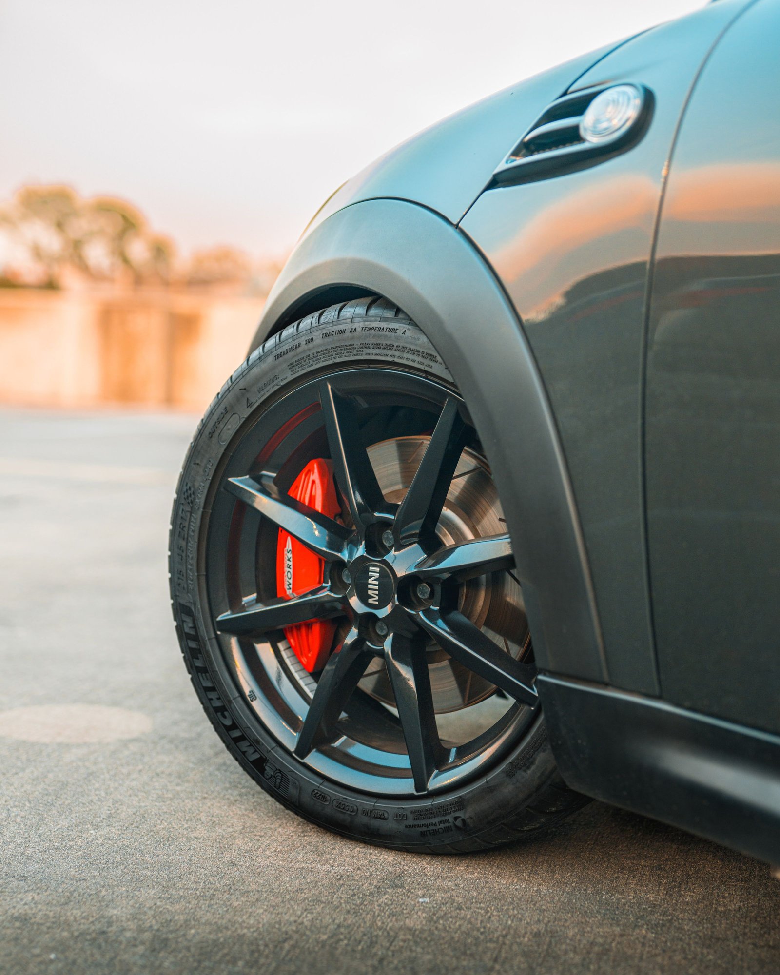

Time to revive this thread! Still running the same wheels from a few years ago. Recently installed Bilstein B14 coilovers and have also switched to 215/45R17 Michelin PS4S, from the awful Potenza S001's that came on those wheels. Absolutely love this setup, been doing some autocross as well and it tears it up!
People are still so surprised that these are Miata wheels. Most people don't notice unless I mention it - they fit so well on these cars!

They look good on Miata's as well. Going from MINI to Miata is easier, just centering rings.

The car and Stig pix look awesome. Think PS4S will be my next set up.

I agree, car looks great! Also, your car made me select and install the B14 kit too
