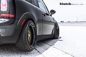

Hi,
Please help me determine this tires!
Thanks!

195-40-16
hes stretched. This is a guess. Beyond that you need to camber your car and trim the fenders.

Thinking about returning this wheels. lol

lol why? You have all the parts for a good fitment. Well it’ll look awkward if you don’t lower it to kill the wheel gap.
if you’re looking for stock fitment the +40 would’ve been in your range. 7inches wide.
My future wheel setup is 17x8.5 +30 205/40/17
im on oem 17inch wheels and I still had to trim my fenders with how low I am.
