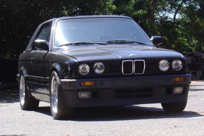

The same wheel and tires on a BMW looks like this:
http://www.r3vlimited.com/board/atta...6&d=1315104987
