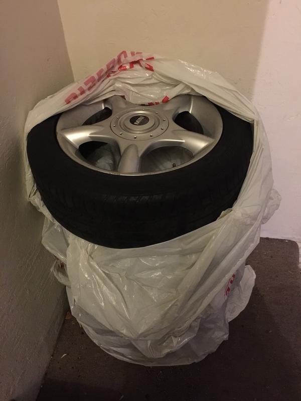

Well, I did it...bought the R83 wheels for a great deal. I will wait a couple more months until the old 17's are worn out and then give them a try.
Thanks to all for the help!
Jeremy

Hey all, I just thought I'd follow up on my questions here. Last Friday I had new tires mounted on the R83 16" wheels and installed them for the first time, coming from worn-out regular (NOT run flat) 17" tires. I went with Falken (inexpensive) touring tires in 205/50-16. They have an excellent treadwear rating and mileage guarantee. But as I said in the beginning, I was looking to take the edge off the hard, jiggly ride...
...and...
Success! Holy cow, these tires and wheels make a HUGE difference! It's still a Cooper S, not a Cadillac, but it definitely took a significant amount of hard edge off the bumps. We have some bad, tar stripped, potholed, jiggly roads in Tucson and this is much better. There's one fun corner that we take at 50mph which has cracks and tar strips. It used to take that corner skipping off the strips which actually caused it to lose traction tiny bits, now it stays planted due to the compliance in the sidewalls absorbing the strips. Very pleased with this. Also, much reduced is the sound of the interior and convertible top getting jiggled apart on such roads. There IS a tradeoff, the steering response is noticeably less sharp, but this car is so sharp anyway that to me, on real world roads, this is a worthwhile trade.

We've had the 16's on for over a month and one road trip now, and we couldn't be happier with the switch from 17's. I think the tires "wore in" just a bit (mold release agent, little rubber protrusions, etc) and some of the sharpness returned, and the ride is so much better. Makes for less shaking and jarring, plus the car feels more stable and planted on jiggly roads, especially in rough curves.
