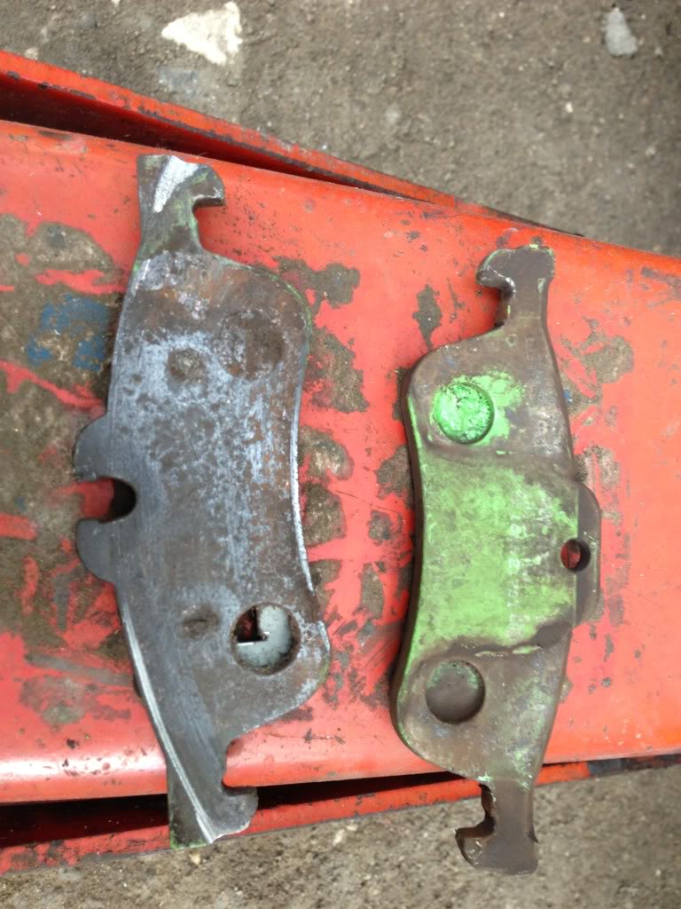

Loved my Greenstuff. Low dust, good braking. Heard stories of pads disappearing. Brushed em off as random as mine worked fine. Halfway thru its life, still worked great.
Then a week back, felt binding on reverse. These were intermittent. Then, my Ol' Gray 02 R53 (48k mi, never sees track nor abuse) evolved to having HILL ASSIST! Thought: this just can't be! Shared this phenomenon w/ my buddy, Da Mastah. Thinking my MINI must be special. Think Herbie!
Jacked up the car today puzzled. All Rotors were freewheeling, no binding at all. Drove to work up the hills.... Imagine my horrific drive downhill! Rear brakes created grinding noises I've never heard before, pedal went deeper, then back, losing grip. Fronts kept the car in check. Babied it right to my mechanic buddy's doorstep.... Pics say a lot:
LH rear- Lost the inner pad (left on pic)

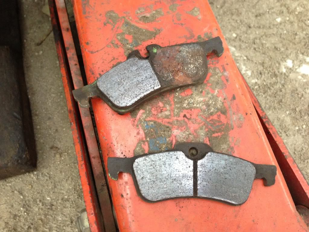

RH inner pad had partially delaminated, detached upon pad removal (top of pic)

Felt extremely blessed! Those w/ EBC pads, swap em out now! These are accidents waiting to happen.
EBC, WAKE UP!!!! Your pads aren't safe!

How much pad is left?
MINI's spec is the pad should be replaced at 3mm. I think EBC recommend 4mm. I've had bits fall off my Yellowstuff track pads, but only when they got below 4mm.

We've sold hundreds of sets of EBC pads without issue. This is the 3rd set I seen someone complain about, 2 sets by the same person so that is an odd coincidence?? From looking at this set it looks like they were pretty worn to begin with.
I ask how long the car had been sitting before driving it off and having them come apart? Because I have seen pads rust to rotors and chunk apart because they were stuck.
I would be interested in hearing what EBC says after seeing the pads as they have always been good to deal with.
I'm going to continue selling them as they've proven to been good pads with how many I've sold. Just hope isolated cases like this don't ruin a good product.

Car is used 3-4 times a week to work, never abused nor tracked, have never even seen snow! Pads regularly checked & have half left. The LH inner pad went, while the RH dis-bonded half after removal. I loved how these worked & even brushed off failure posts.
No one should ignore safety. I'm just putting this out there (from 1 mini owner to another) to help prevent accidents from happening.

How old are these pads?

Pads are 4-5years old. Have other cars w/ older pads & no issues.

You drove the car 3-4 times a week and had the pads on 4-5 years, seems like you were a bit over due for new pads wouldn't you say? At least I always change mine 2-3 years depending on how hard I drive too.

Could be due to age. The thing is, I rotate my cars & none of the others in 3 decades of driving has seen failure like this, even with older pads on much heavier SUVs.
Just warning everyone to check pads regularly. If you suddenly develop the symptoms I got like HILL ASSIST when you don't have this feature & resistance on reverse, replace those ASAP. Brake failure shouldn't be taken lightly. I've ignored the failure posts, never believed it could hit me.
