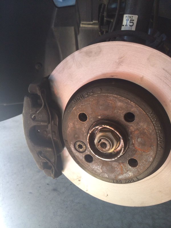

So I guess my question is, do I need those slide clips? The brakes were serviced at 32k miles with the original first owner. The dealership must've been lazy and didn't put new slide clips on. The car now has 41k miles and I'm turning all of the rotors (front and back). The rear brakes don't have the slide clips on them either FYI.
Old Oct 14, 2013 | 11:57 AM
  #43
Posts: 36,762
Likes: 2,551
Yea, Those pics for the brakes above for the R53(JCW) and R56+ brake. Your R53 Cooper S on stock brakes does not have those clips.
R50 R52 R53 Gen 1 front brakes. #15 does not have clips on the top and bottom.
If you could take a picture of your brakes I can help you.

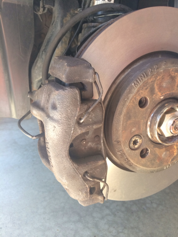

Yea, Those pics for the brakes above for the R53(JCW) and R56+ brake. Your R53 Cooper S on stock brakes does not have those clips. R50 R52 R53 Gen 1 front brakes. #15 does not have clips on the top and bottom. If you could take a picture of your brakes I can help you.
Hope this helps. So what you are saying is that gen 1 mcs do not need slide clips?

Correct those metal clips are not for your stock R53 Brakes.
Couple tips. .. .
Here is your diagram for your brakes.
#4 is the outside clip, looks to be good on your car but if its is bent or broken on the rod going into the holes , replace it. It also applies tension between the caliper and the caliper carrier. Part # 34111512715
http://www.ecstuning.com/Search/SiteSearch/34111512715/
The clips that are on the inside pad (three prone ) , that you see below make sure the are press all the way in on the piston and flat against the pad backing.
http://www.ecstuning.com/Search/SiteSearch/34116770332/
Wire brush or clean the siding points on the caliper carrier where the ears of the pad backing slides into. Little notch on the top and bottom. You can see it where the pads rest on the large #2 pic on the attached thumbnails.
Also its a great time to inspect the slider boots and and pins to make sure they are sliding correctly with a little tension. Pull the pins out and clean them. The boots can get rust between the boot and caliper , pull the rubber out and look at it. Replace the sliders if worn.
One set for each caliper.
#13 in the above diagram. Guide Bushing Set - Priced Per Caliper Part # 34111157038
http://www.ecstuning.com/Search/SiteSearch/34111157038/
Here are the pins bolts:
#5 in the above diagram . Caliper Guide Bolt - Priced Each
http://www.ecstuning.com/Search/SiteSearch/34111157041/
Also when you put new rotors on make sure you wire brush and clean the hub and flange. Makes the new rotor seat correctly and change out those rotor screws and apply some ant-seize to them on the threads, so they are not a pain to take out next time.
#12 on the above digram. Brake Rotor Set Screw - Priced Each Part # 07136772426
http://www.ecstuning.com/Search/SiteSearch/07136772426/
If you do these thing you will eliminate most problems.
