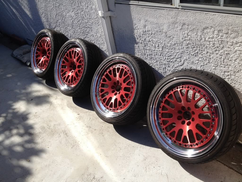

CCW Classics: 18x8 +32
Falken 452: 215/35/18
R56 can run wider without rubbing... Asking for a R53 GP
