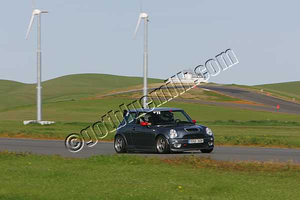

True about revs high (in power band imo) just got to remember that when you are just over redline in your current set-up, you will need to upshift with 205/50-15. My first session with this size I got blackflaged cause I constantly over revved engine that overflow tank leaked and smoked. After that session I got used to it. The Hankook RS3 in 225/45x15 is a tire I want to run as well, out of laziness to switch wheels, have read that this tire loves to run hot. Here is a pic of 205/50-15:
