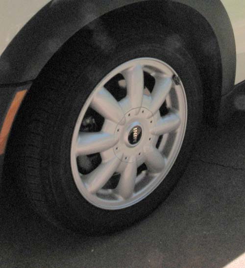

Original wheels
'04 window sticker just say "alloy wheels" - am uploading photo.
Thanks!

With the stock 15" tire size, it has to be on 5.5" wide rims.
Any idea what tires you'll be getting?

OEM R82 wheels are 15x5.5 ...
