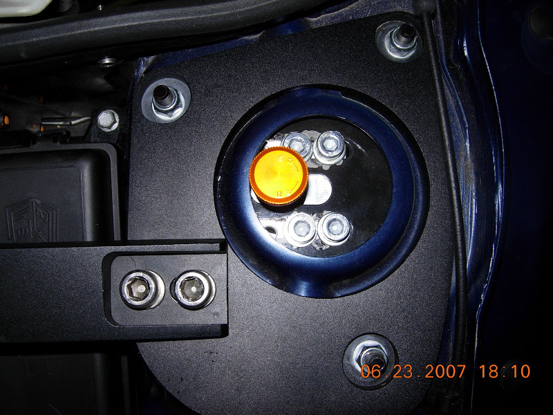

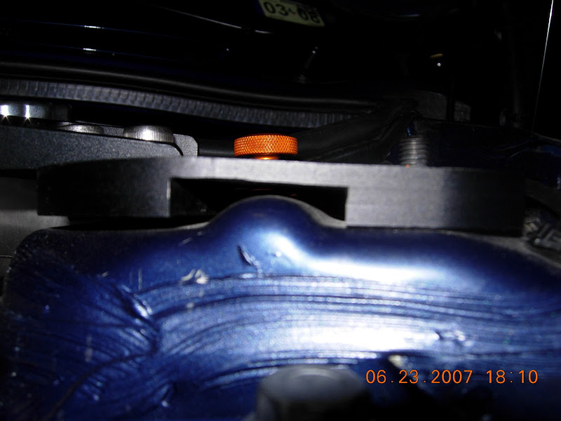

The capable TSW guys installed the cable adjusters today at the TSW World HQ.
The front's were a breeze to install with the IE Camber Plates, plenty of room. The black knurled extension grasp the shock adusment location and a short post from the top with silver set screws. A larger diameter orange anodized **** with ingraved arrows for Hard and S graces the top. The overall height is lower then the M7 Strut bar so does not touch the bonnet insulation.
The rear is a bit more work. The extension is 18" or so long. The rear coilovers needed to come off, on a new install you would do this before installing the unit. Some of the interior rear trim needs to be removed. A hole slightly larger then 3/8" was drilled into the frame rail and rustproofed. Thwe adjuster was afixed to the top of the shock and fished through the new hole when reinstalled. The same orange **** used in the fronts is then affixed. We decided at this tiome to access the adjuster via the panels located in the rear. Just pop em off, adjust and back in. I'm going to scout around for other locations.
Sonce the intial install everything has been set at 7 of 12. We turned the adjustment back by 3 and test drove. Much nicer ride. Still easy to drive, but less jarring and over all smoother. Haven't put many miles on it like this yet and track is still 2 weeks off. Will add more after tracking.
