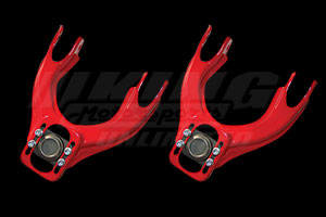

Camber plates move the top of the strut in to achieve more neg camber, could not the same results be achieved by moving the bottom of the strut out? If you look at Madness' control arms and imagine that they had some adjustablility, it would seem like that might be an alternative to camber plates. No one seems to make them, I was just wondering why. It would be more expensive, of course, than a camber plate, but it seems to me it might work better.
Not for MINI's, but you get the idea:
Or it could be that it couldn't have the necessary strength. I don't know, and I warned you it was a dumb question, but it seemed reasonable to me at the time.
